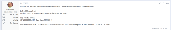

Andy sent me over 3.120.0000000.39.R.230918 and initial testing seems that this older firmware resolves the problem. Seems like a bug in the latest firmware V3.140.0000000.22.R.240618.
