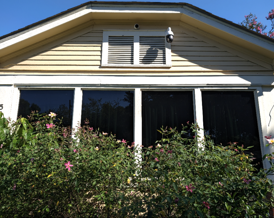

Do you happen to have a pic of that PTZ on a house just so I can get an idea of what it might look like? I’d definitely be putting it on a second story soffit for best view.

Mounted that high it shouldn't be a problem. Just remember that the closer they get to the house the harder it is to get a good shot of a person's face because the camera is looking down. That isn't a problem with the ptz @wittaj suggested if you set it to start tracking from a distance. Someone's posted how to calculate it. And if I get a chance I may dig it up.

On the other hand, if you get that ptz, I doubt they'd be stupid enough to come on your property. When I first got it, it was fun to watch as people walked by on the sidewalk and watched it track them.
