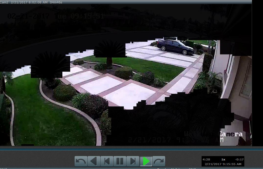

I've been toying with the Motion Sensor settings in BI and have excluded the street in front of my house but when I view video recorded that whole area is masked off too. I'd like to have the whole picture and thought this was for setting the area where motion will trigger a recording and send me a text. BI is still sensing cars on the street in front of my house but I get this (screen shot) as the video although the snapshot shows the full scene. I'm not sure what I did wrong. I'm still getting motion detected outside the zone.
Yo! The blacked out areas are only for countries where you are not allowed to monitor for instance your neighbors house. You will stay in compliance by having the camera pointing at their house but it's "blacked out" so no footage is recorded there. It is NOT for a motion detector zone.
