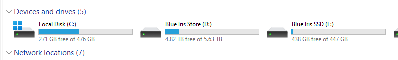

dannieboiz
May 13, 2015
491
71
Here you go.
BI, DB and Windows on the same SSD. Here's where we stand

dannieboiz
May 13, 2015
491
71
without looking at any of the above posts, I'd call a red flag on assigning "New" to the SSD. Create a New on the 6TB drive. don't waste cpu cycles moving data around.
If I put New on the 6TB reviewing recording and alerts is extremely slow. I made a post of this awhile ago and was recommended to put it on an SSD>

dannieboiz
May 13, 2015
491
71
If your gonna play with NEW on the SSD, I would not try to use every sqaure inch of possible free space, before it moves the files. Windows needs Swapfile ( or whatever they call it now) free space on the disk maybe like 10-15%.... make sure disk defrag is off on the 6TB drive. make sure Windows defender is not scanning that drive.
I have 447GB of space and is only allocating 400GB. When defender is disabled.
