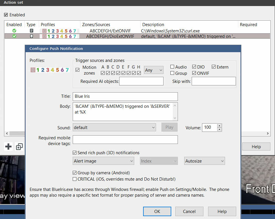

I assume you’ve set the curl ’Run a program’ action in the ‘On alert…’ page on camera settings ‘Alerts’ tab. Two things that might explain why it’s not working (as well as the ‘Push’ action) is if:
  • you’ve inadvertently unchecked the ‘Enabled’ option at the top left corner (see screenshot).
  • the curl and push actions are disabled for the profiles of interest.
If this is not the case, did you try assigning the curl action to a camera preset as I suggested previously (for testing)? An alertnative is do what @sebastiantombs did - set the curl action in the ‘Immediate actions’ option on the ’Trigger tab’.

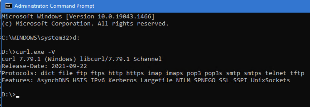

Sounds good. If you see the following response by typing ‘curl.exe -V’ into a cmd.exe window after changing drives, then curl.exe is on your path.
