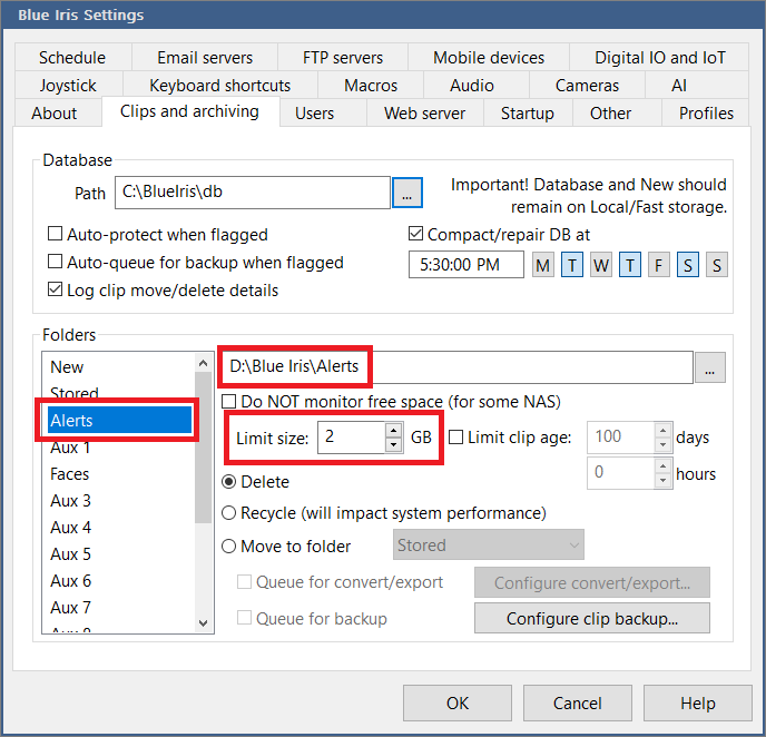

Deleting hi-res images in the ALERTS folder may also cause this; I need to test this.
EDIT: Not the case. High-res *.jpgs are being deleted regularly because I've limited the size of this folder.

Have we confirmed that the default 2AM database compaction will affect our abilty to pull up images and alert videos the next day? I will be testing that tonight, deliberately leaving some Pushover alerts from this evening as unviewed until the morning. If I understood correctly, that may have been a false impression, muddled by other interactions.
It affects anything that uses the &ALERT_DB macro
I've verified it and changed my compact/repair schedule as a result. I've not gone totally manual like @wittag; I do it at 5:30p every other day.
I don't think you need to leave the Pushover notifications unviewed to test this.
You can view them now, before a db compact/repair, and the links work. Then again after a manual compact/repair, and the links don't work.
