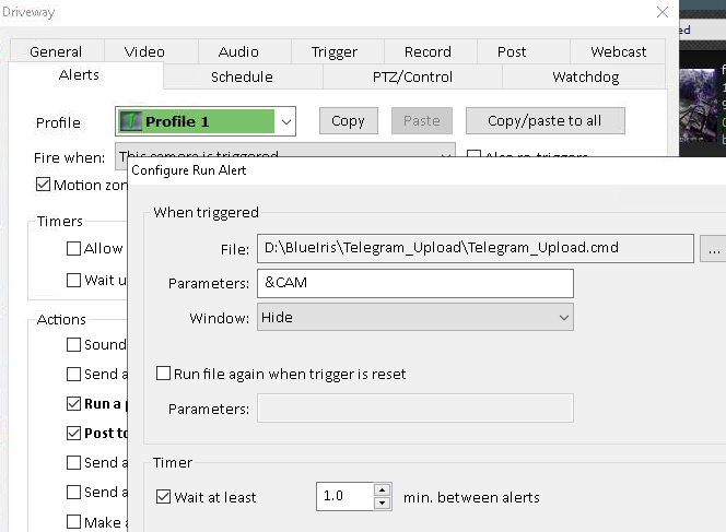

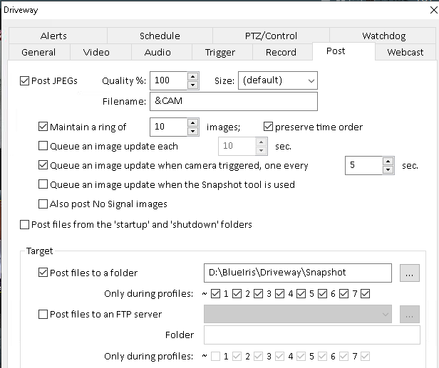

really like this approach! could you help me adjust the code so it sends the latest N pictures instead of a single one? thanks!!Heres how I do it:
1) Download curl for Windows from curl for Windows and copy the bin folder (in the zip file) to a location (I put mine into D:\BlueIris\Telegram_Upload)
2) Configure the BlueIris Camera: Post. Define what folder you are going to export the motion snapshots. Make sure it is a folder with the same shortname as the BlueIris camera.
3) Download, extract the zip file Telegram_Upload.cmd.txt (rename to .cmd) to the same location as step 1.
4) Modify Telegram_Upload.cmd (previous step) to reflect your details and file locations
5) Configure the BlueIris Camera: Alert
Tick "Run a program or execute a script" then click Configure button next to that
https://api.telegram.org/bot<BOTID>/sendphoto -F chat_id=<CHATID> -F photo=@D:\BlueIris\Alerts\&ALERT_PATH -F caption="[*&NAME*](http://<BIDOMAIN>/live.htm#&CAM) \- &MEMO" -F parse_mode=MarkdownV2
