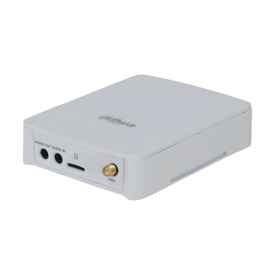

Looks like I need to research "modular cameras", the processing is unit is separate from the sensor and lens. This would make it much easier to hide the cameras.
Oh boy these AXIS systems cost an arm and a leg! Too bad Dahua only makes those pinhole cameras with very small sensors.
Both dahua and hik make modular camerashttps://www.dahuasecurity.com/asset/upload/product/20180110/DH-IPC-HUM8431-E1_Datasheet__20180108.pdf
I dont believe they make them with more than one camera per box though.
Thanks for sharing this. Are the sensor units connected to the processing unit by coaxial cable ?
@fenderman Do you know which unit is newer? The one with the USB connector for the sensor or the one that looks like one or two coaxial connectors?
IPC-HUM8441-E2 ^
IPC-HUM8441-E1 ^
IPC-HUM8431-E1 ^
Do these units work with IR light or natural light? I'd prefer to add IR illuminators, not natural light LEDs.
EDIT: added images after looking at all the models
My timeline to purchase is around March next year so I haven't pulled the trigger yet. I decided the modular cameras are the way to go for my use case and in particular IPC-HUM8441E-E1-L3-S2 (wider aperture 1.6 than the other models). I will build custom aluminum enclosures for the sensors and mount them in the spots I showed in the sketches. I simulated their field-of-view in 3D and those spots give me 360 degrees coverage around the RV. The processing units will be inside the camper away from the elements. I will also add IR LEDs around the top to ensure enough illumination at night.
I wish the modular units were more popular on this forum, it would have been great to hear feedback from people with first-hand experience. Maybe I need to post in the Dahua subforum.
