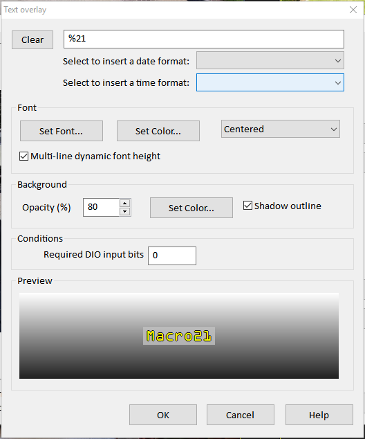

1. Via the Video Overlay dialog (Image 1), create 3 macros %21, %22, %23 with the text color & background opacity/colors you prefer. To make it easier while tweaking, start with them not on top of each other; you can overlay them when your are done testing.

Image 1
Blue Iris Video Overlay dialog... before assigning a string (or file) using the HTTP Interface commands above.
