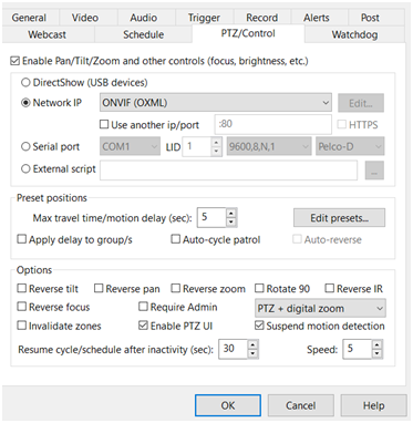

I will post screenshots of the PTZ settings. I do not remember having to do anything under that tab, but maybe the default actions have changed since I set it up and a simple check box on that tab somewhere will make your work. If so, I will update the first post to reflect that.
OK, here are a few areas in the PTZ camera settings that could impact it going back.
Off the top of my head you are correct that looks like the default menu settings.
I did notice that one check mark to resume cycle/schedule after inactivity. I do wonder why that is there when there is already a break time on the main camera page. Either way for my settings I know I changed it all for 20 seconds for troubleshooting purposes as I didn't want to wait a full minute for all the testing I still have to do.

If I move the PTZ in BI, after 30 seconds it returns back.
If I move the PTZ in the camera GUI, it stays there until I move it.
So my PTZ isn't administering the idle return time, it is BI.
Do all of your screens match mine above? Maybe time for a delete of the PTZ camera and re-add?

So I deleted my spotter cam and PTZ in BI and re-added.
It works as intended and goes back. Confirmed a home setting is not in the PTZ.
