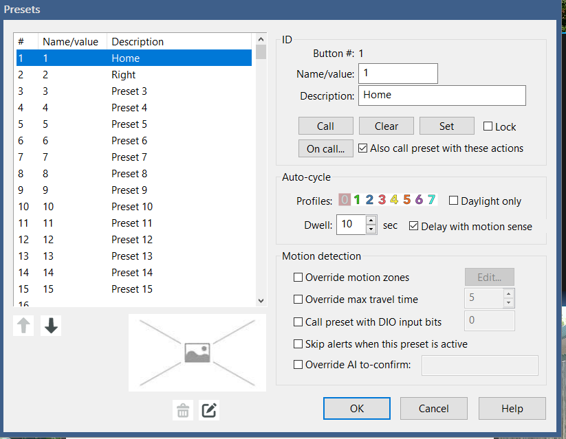

Another question:
When the ptz is already recording/tracking/triggered
How do I have the ptz ignore the spotter cam's new 'do command' request/alert and not have the ptz move away?

You can go into the PTZ tab in the Camera setttings and go to the preset that you want to have priority and check the "cancel alerts when the camera is focused on specific PTZ presets" box and then if it is tracking on that preset then another spotter cam will not override it.

Here?:
"Skip alerts when preset is active"
I only use two presets: home and Right
So check that on the preset: 'Right'
Because if I check that on preset 'home' it will skip any calls to 'right' while it is sitting at 'home'
