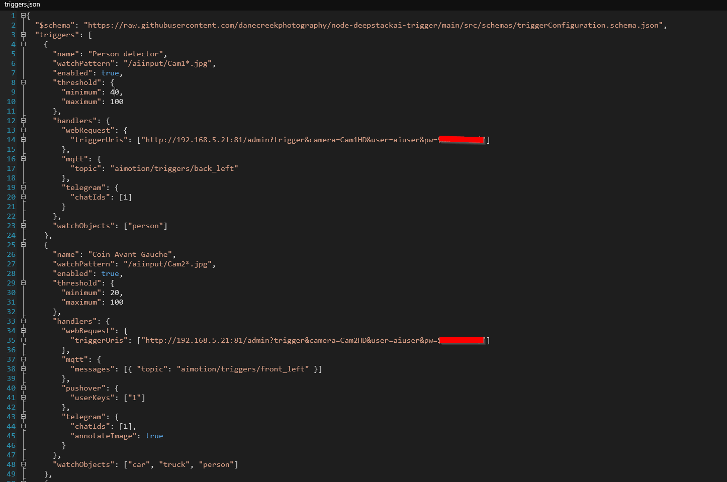

Can anyone who's gotten this to work send a copy of their triggers.json file? I'm having difficulting understanding how to modify mine using the example.
Thanks.
There is mine... I hope this help.
