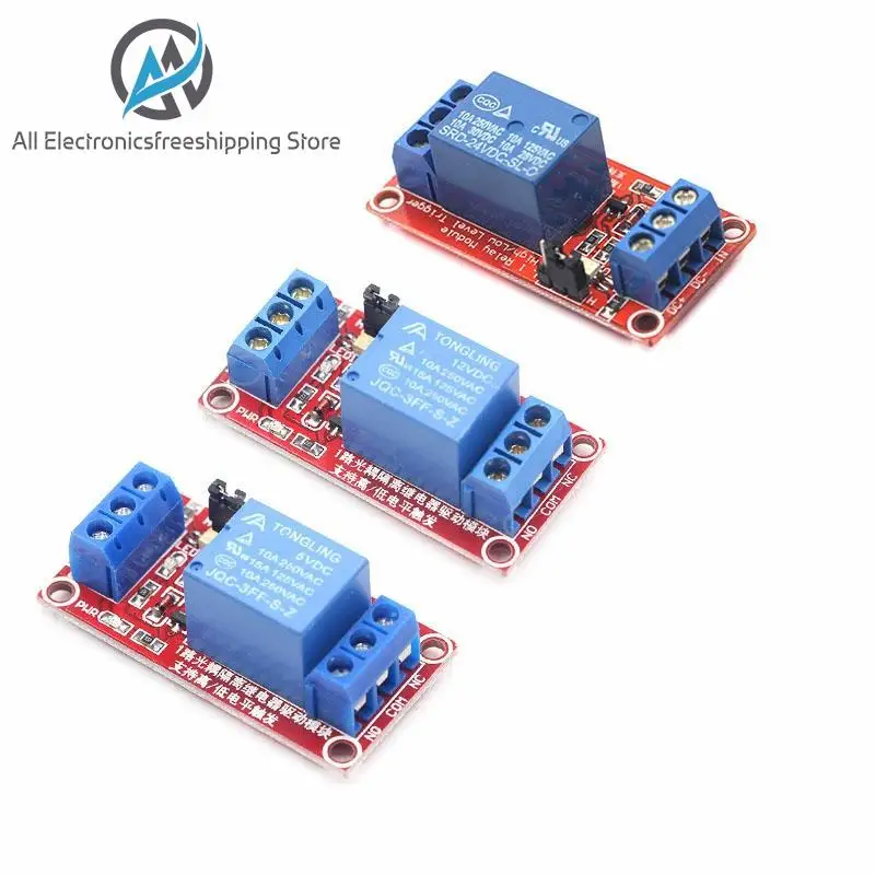

If you already have the 8-12V AC chime already installed, might be you can just add a 24V relay which powers both the relay and doorbell and have the doorbell trigger the relay in.
(I'm not exactly sure it's the correct one that will work, someone with better knowledge can correct me)
