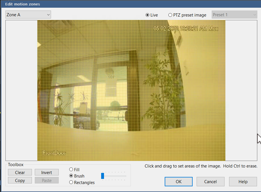

I'm just setting up a new site, so most things are set to defaults, but I'm having a hard time figuring out how BI did NOT trigger on this motion. When I review the New clip in UI3, I get lots of yellow rectangles, but no orange rectangles:
Default settings for motion detection and zones:
Later events on the same camera triggered properly, so the feature is turned on, but it didn't trigger on this very obvious, very large, very contrasty motion this morning.
Am I missing something extremely obvious?

Update:
I left the setting unchanged for one day, just to be sure it was a repeatable problem and not just a one-off. And the next day I got the same result; employee comes in, and does not get detected.
So I made both of these changes:
Shut off, uncheck, "object detection". Just a guess but I'll bet the lighting change was seen by object detection so it ignored the motion detection.
also use the simple algorithm not edge vector. You might want to change your alarm code as anyone who knows you and sees the video now has your code.
The following morning, my employee was detected as he came in. As he was also this morning.
But then, 5 minutes later, he comes back to put a key in the deadbolt, and there is no motion detected:
Detection settings are at the same defaults as screen-captured above, e.g. Min Size: 550, Min Contrast: 40, Min Duration: 1.0.
Is this setting hiding somewhere?

I am reading the instructions, and I still don't understand how this motion is not detected.
Yes, I made both the changes suggested by you and by sebastian, e.g. un-checking Object and changing from Edge to Simple.
I just now lowered the duration to 0.7, but as you can see in the above video, he's walking across the scene for at least 3.5 - 4 seconds.

Sorry for the lack of clarity:
Case 1: Settings as screenshotted above: ✅Object, ✅Use Zones, Edge Vector, Min Size: 550, Min Contrast: 40, Min Duration: 1.0. Result: Entry event not detected (1st YouTube video).
Case 2: Settings unchanged. Result: Entry event not detected. No YT video, but looks substantially like the first YT video.
Case 3: Object UN-checked, Algo changed from Edge Vector to Simple. Result: Entry event detected, but key insertion not detected (2nd YT video).
Current state: Duration reduced to 0.7. Awaiting results . . . .
The camera is an Amcrest IP5M-T1179E:
