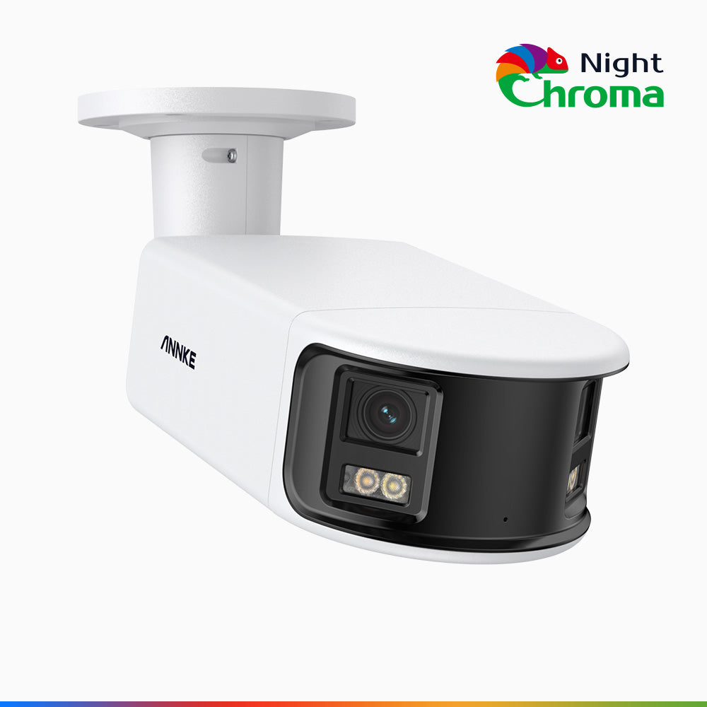

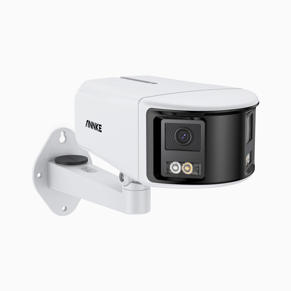

Wildcat is doing review on the Dahua DH-IPC-PFW5849-A180-E2 - Dual Lens 180 Degree Full Color 4K (8MP Stitched) Camera here. But this model only on-camera LED light no IR though.
The Annke's FCD600 - Panoramic Outdoor PoE Dual Lens Security Camera, 6MP Resolution, 180° Ultra Wide Angle. It has two lighting modes, IR fill light: black and white picture; white light fill light: color night vision. ($129.99)
And the NightChromaTM NCD800 – 4K Outdoor Panoramic PoE Dual Lens Security Camera, f/1.0 Super Aperture. $389.99 also no IR but better picture quality.
Reactions: TheWaterbug
Reactions: JDreaming
