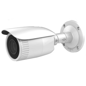

I've spent a while looking around and found the following:
It is a mini bullet camera, small enough to hide by placing high up, but I'm confused about the sensor sizes so not sure if the sensor is too small or not.
This may seem like a daft question, as I presume the smaller the number the smaller the sensor, but I just want to make sure this is the case, so out of the following, which is smaller?
1/2.7 or 1/2.8
Thanks for your help too btw and glad to hear that your CCTV was put to good use :)

You are looking at a budget cam, which use lessor quality material and sensors to sell a MP that the uninformed general public thinks they want.
Sensor sizing can confuse a lot of people LOL.
It is simple division:
1 divided by 3 equals 0.333
1 divided by 2.8 equals 0.357
Is a 1/2.8" sensor bigger than a 1/1.8" sensor? Most people say yes LOL. But it is a fraction, so the 1/1.8" sensor is the bigger of the two. A 1/2.8" sensor is smaller than a 1/2.7" sensor. Your existing camera on a 1/1.2" sensor is large by comparison, but if put in the wrong location, it will suck.
This applies to camera sensors too LOL:
Stay away from those 5MP. Ideal sensor size is:
2MP = 1/2.8"
4MP = 1/1.8"
8MP = 1/1.2"
So simply doing a ratio, a 5MP would need a 1/1.65" sensor to be comparable, and we just do not see a 5MP on a sensor any larger than 1/2.7".
The budget cam will make for an ok overview camera, but you shouldn't expect IDENTIFY capabilities from it in most instances, especially on a 2nd story. A 12mm focal length at best will IDENTIFY at maybe 30 feet out at night. Most of that is lost in the vertical.
