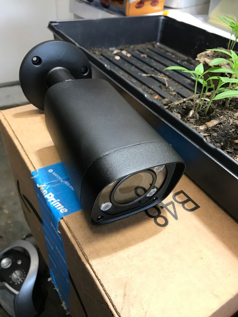

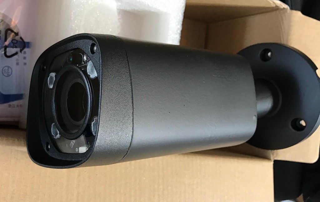

New Black version :)
Can't wait to get these two cameras installed for our system:
IMG_5231%202_zpskpjz6y24.jpg~original
IMG_5228%202_zpscckr2wvq.jpg~original
Not legit. I got excited with the spray can. I like my cameras to blend into the forest a little better then bright white. And heat isn't much of an issue here.
