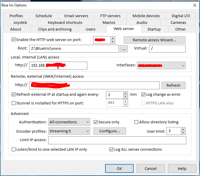

New GUI is awesome and I have no problem at all logging in to BI and get ui2.htm as the default page when logging in from different computers locally within my LAN.
The new GUI is really cool and slick!
However, when I try to access BI remotely via WAN I do get the new and modern login page but when I enter my login credentials it just reloads back the page to the login page again.
If I start a SSH session to my router with Putty and create a SSH tunnel and then do "localhost:portnumber" it works fine to login.
So this seems to only happen when I try access directly BI via WAN (this worked fine before the new GUI was introduced)
I have tested with both having "ui2.htm" populated in the "home page"-field for the user in BI and with that field empty but no difference. It just reverts back to the login page when I press login.
I have also made sure to restart browser (both Chrome and Firefox) to make sure nothing is cached.
My webserver setup params in BI:

For anyone experiencing a similar issue, the problem Jury was having is that Blue Iris appears to be sending a "403 Forbidden" response where it is expected to redirect to the user's homepage. Everything looked fine and normal all the way through the login procedure (the login completed successfully) but something failed afterward. I informed the Blue Iris developer of this, but I suspect more people will have to report it before he can find the cause.
CrazyFin's situation sounded a little different so we'll see what happens there.
