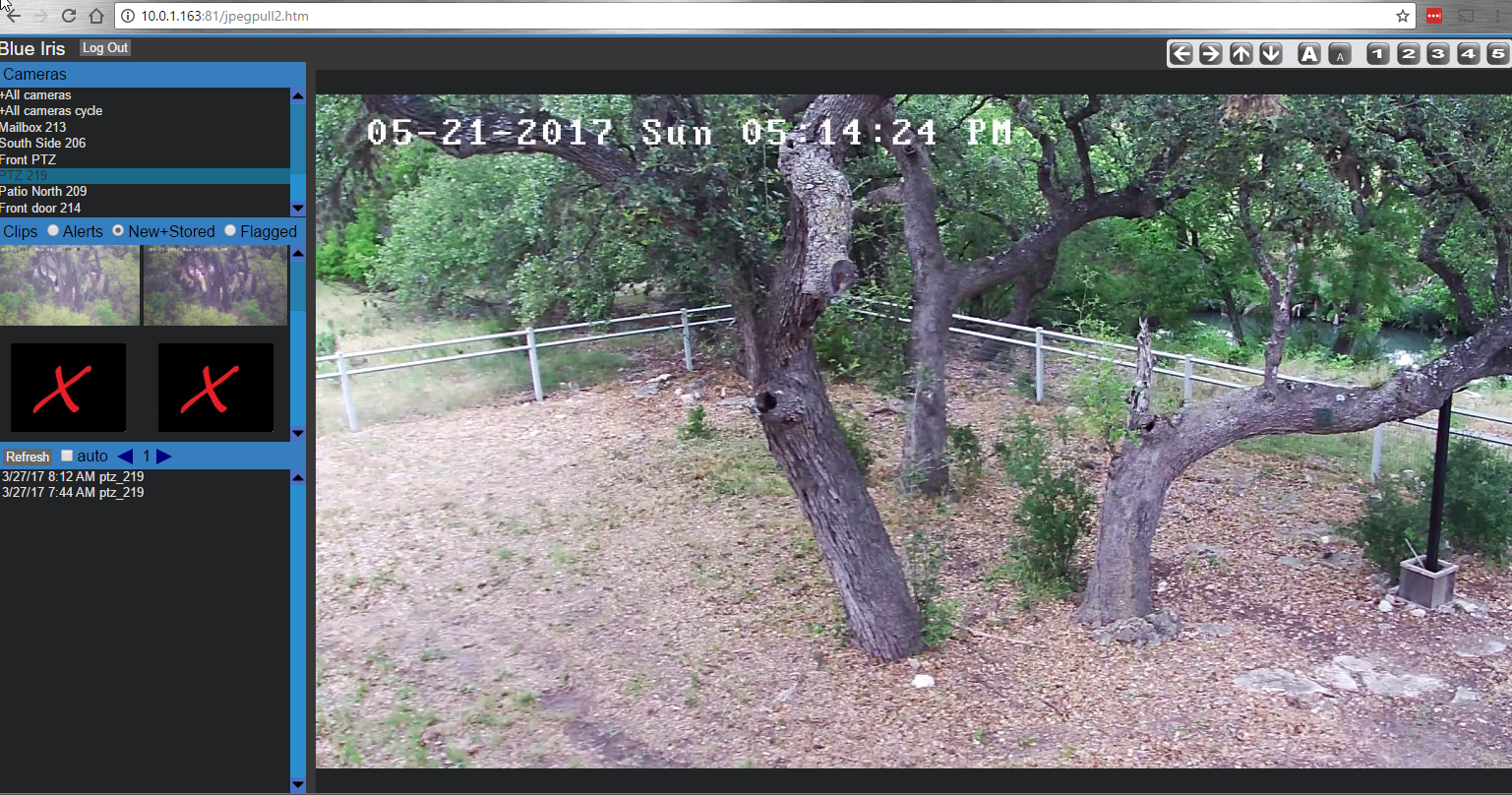

I noticed a small visual issue with the hard drive space being show on the top bar.
I run 2 separate drives and it looks like the second drive gets cuts off.
I don't look at it to much, but I just wanted to let you know about it.
