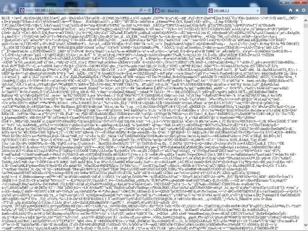

When I use the download option from the clips pane on the left, I always get a new tab just filled with code, see picture.
I was looking to create an auto update script with powershell and I was wondering what method you used to check to see if an update was available?
When I use the download option from the clips pane on the left, I always get a new tab just filled with code, see picture.View attachment 23801
Internet Explorer apparently has trouble with this. Blue Iris doesn't specify the type of content being sent, so IE interprets it as text instead of a file download. I've asked if this can be fixed in Blue Iris.
