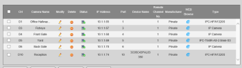

I have a Dahua NVR 16 channel running 6 cameras. I recently added a new camera (IPC-T54IR-AS-2.8mm-S3) and for some reason it won't show up in the DMSS app.
It will show up as a channel in DMSS but only the refresh image is shown. I've tried deleting/reloading the NVR on DMSS and still nothing. I can view it fine in the NVR software.

Post a shot of your NVR camera registration screen and point out which camera this is..
How did you add the NVR to the app? By IP, serial number, or QR code?
Thanks for the quick response. See attached for registration screen, it is port 5 that is giving me issues.
I added the NVR using the QR code. I have a few different NVRs in different locations and have never had an issue like this before. I even have the same camera at a different location and it works on DMSS.

You added the NVR right? not individual cameras on the NVR internal PoE ports.

If the same camera works on the NVR/DMSS at a different location, the problem sounds to be with a setting or problem with the NVR
That kinda proves it’s not DMSS that’s the problem. A new app won’t fix anything
Try switching the cable to a different port in the NVR and doing a factory default while connected to the NVR
