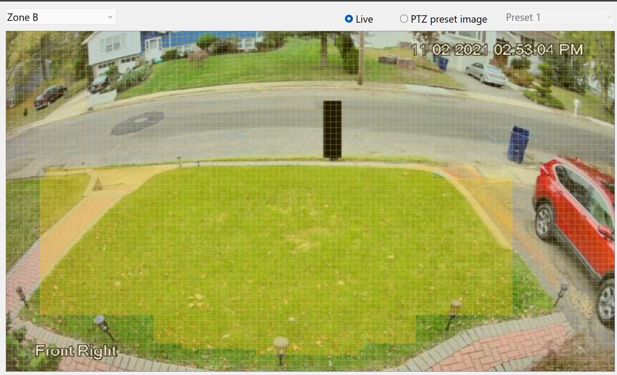

Below are the four views (the blocked out area on each is a mailbox which DeepStack constantly IDs as a person with over 80% confidence - I'm open to suggestions as to fixing this as well):

All of the cameras have the same basic setup for motion and zones:
  • Zone A is the entire frame
  • Zone B is my property
  • Zone C is a block on the street which is centralized.
  • I am not using any motion or IVS capabilities of the cameras.

Depending on the BI version you are on, you could unhighlight the mailbox in the zone area and that will eliminate DS thinking it is a person and thus eliminate that ugly black mask LOL.

I still cant get the one part of this worked out.
I have cloned one camera. I am eliminating all street alerts from the other cameras until I wrap my head around this. For the clone, I just want to figure out how to fire an alert if a car stops in front of the house.
On the clone camera I kept the zones the same - A is everything. B is my property, C is a rectangle covering the street directly in front of the camera - about three car lengths wide.
