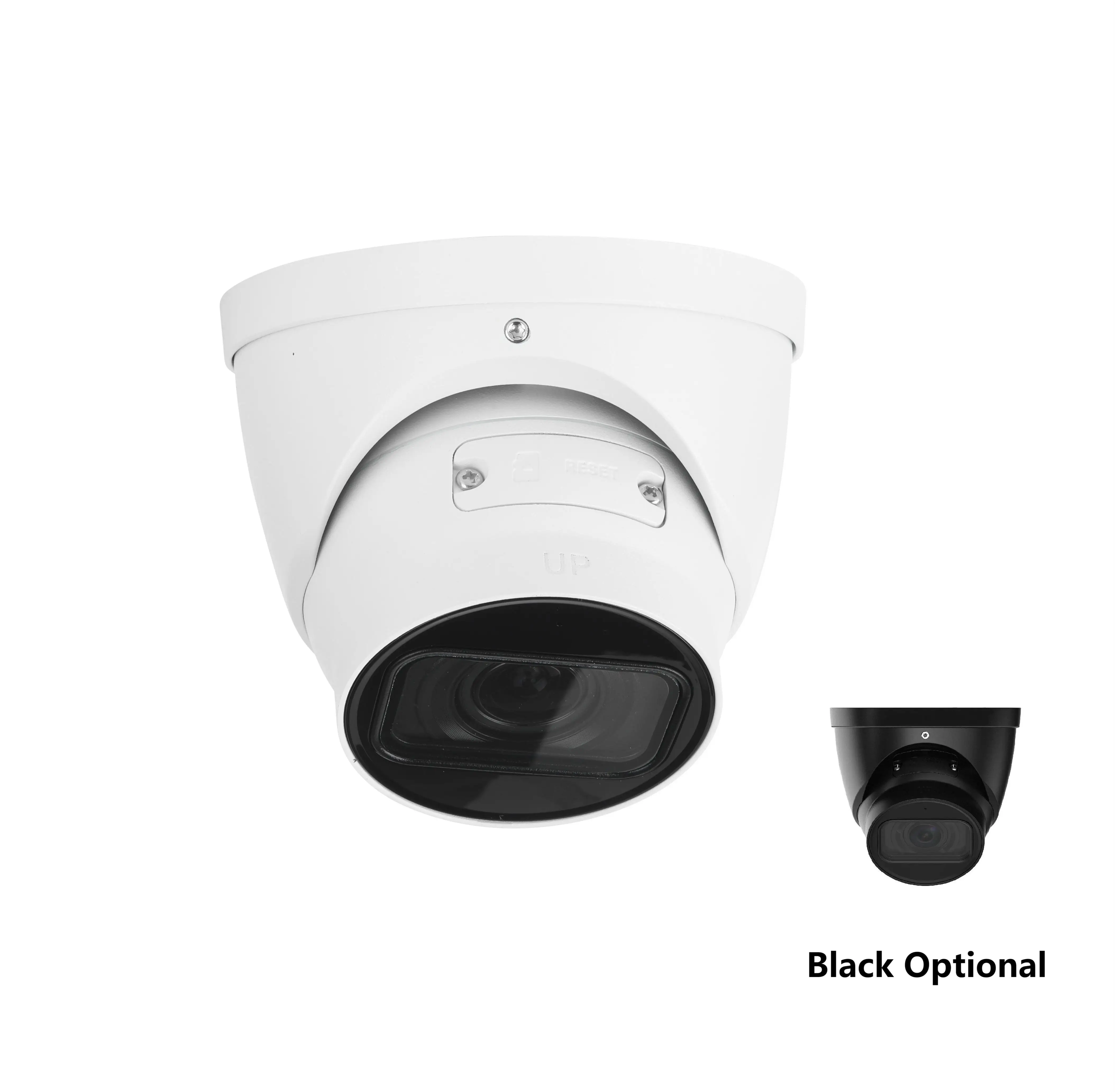

Nvr with poe built in, either the 4208 (I chose that one myself) or the 5208.
These cameras x 8 or less if you're not ready.
Or the same in varifocal where you can zoom in and set the view
Frankly I think just a 3.6mm fixed camera does the job just fine most of the time. Installing them 8' high is best. The higher they go the less effective they get. I do not favor bullet cameras. Beyond the fact that they can be knocked out of place, I don't prefer them aesthetically.
Stick with your ring pro. I love the ring pro so far.
Buy two 4tb purple surveillance hard drives. Then just a monitor hooked up to the nvr. This gear is plug and play. Email Andy and tell him what you want and he'll send direct from him to you. Personally I don't think you can go wrong with these choices and it avoids a whole bunch of complications that seem easy to those in the know but are head spinners to people who just want good quality plug and play, point and record systems.

I talked to Andy. Great guy! Here is what we came up with. Please feel free to provide any feedback. There are only 2 reviews about the NVR on Amazon and my only concern is the fans in this unit are noisy. Probably justified due to high heat generated. All the Cat6 cables will be run to my office by design. I wanted it there but now I worry it will be too noisy since I work from home and have phone calls throughout the day.
Nine IPC-T5442T-ZE cams
One NVR5216-16P-4KS2E
I will still need to buy two 10TB WD Purple drives. I priced those out at Newegg at around $220 each. Do you guys have a better source?
You are right to be concerned about the fan noise. I don't think you will find it acceptable to be in the same room with it, especially for long periods of time. You can either try and isolate the nvr as best you can, or try and do a fan mod for something quieter (search the forum for that) or go with a non poe nvr which will be quieter, and use a multi channel external poe switch for the cameras. Most people here actually favor an external poe switch. Since my poe nvr is in a room I don't really use, it works out for me. But for sure, the fan noise will drive you nuts if you can't isolate the nvr in a closet or enclosure that while it reduces the noise, also has some ventilation for the nvr.
Also, I don't know exactly how much quieter a non poe nvr is. Someone else with experience would have to say. But I believe it's quieter.
