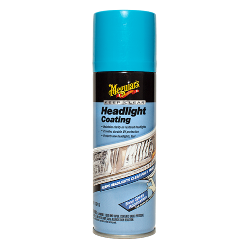

I would be curious if something like this could be put on a new dome and extend it's life.
This company's products always work well.
I have used that exact Meguiar's spray product, but for it's intented use, on headlights. I think one of the difficulties with trying to use it for a camera dome would be applying it in an absolutely perfect coating with the included spray-can nozzle. Remember, our camera's FOV will most likely not tolerate a wavy/orange-peel/splotchy layer so close to the original lens surface. Any of those will seriously degrade the clarity of the image. Headlights will be far more "tolerant" of this distortion, even if not ideal.
Edit: Even after curing, this is a relatively soft coating, not hard enough to consider futher refinement (polishing) post-cure.
