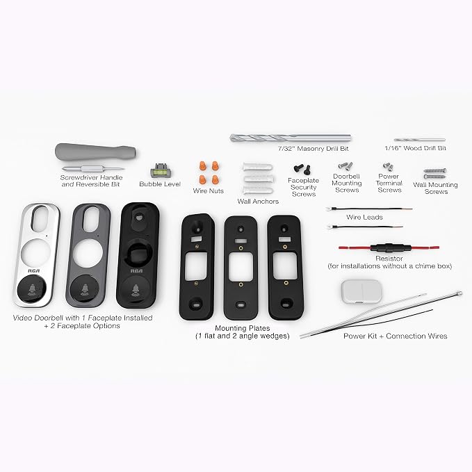

Update: The Nelly's version gets just as hot. I do like that is has no branding on it besides the plastic wrap that has a nelly's tag.
I like the stealth branding on the Nelly's as well, but ended up going with RCA because it was a bit cheaper and they didn't offer a bronze face plate.
One of the product photos clearly shows the RCA bronze face plate without the logo on it. I knew it was a long shot but I was hopeful it would ship that way. Unfortunately all 3 have RCA on them for anyone else wondering.
