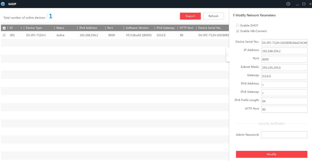

Newbie here looking for some help to change a DS-IPC-T12H-1, firmware V5.5.6_108503, from Chinese to English.
I can see the camera on the NVR due to a language mismatch error. I have the camera connected directly to my laptop lan port using Cat5 and powering through the plug adapter; no I don’t have a PoE switch. Via SADP I can see the device IP and mac address but the Admin password 12345 does not work nor does the serial on teh box (also on the camera itself). I have DL the 5.5.61_180718 firmware and used the tool at the start of this thread to no avail. HELP!
I can’t ping the IP as it times out. I have confirmed, via the mac address and arp -a, that the IP address is correct. I am doing something wrong but have no idea where to from here. I have tried to putty in but that too just times out due to network connection error (re the IP not responding I suspect). Be kind but what is it I am missing here?

Admin 12345 ;)
Show screenshot from SADP with version. Possible ipc not active or....
Tools is not for this ipc ;)

Thanks for the reply. SADP shot below:
Capture — Postimage.org
[/url][/IMG] [/url][/IMG] [/url][/IMG]
In addition to the screen shot are the following fields showing in SADP:
DSP Version: V7.3 build 180326
IPv6 Length: 64
Support IPv6: Yes
IPV6 Modifiable: Yes
Support DHCP: Yes
IPv4 DHCP Support: Off
Support HiK-Connect: Yes
HiK-Connect Status: On
NVR:
HiK connect results in language mismatch error
ONVIF connection results in unknown error (that is what it says)
Not sure what your comment re the password means as 12345 does not work either.
Cheers
Jacko
