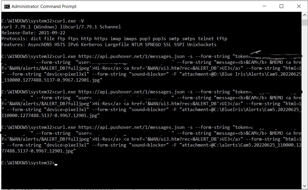

Ok, my computer illiteracy is showing. I can't execute a curl command in admin command prompt. It just starts over with a new blank command entry, no response.
I did use an alert jpg in the alerts folder and tried some other little things like changing D: to E: drive like it's set up on my computer.
I get the same response everyone else gets when I type in curl.exe -V so it's installed on the computer.
Usually with enough time and reading through the threads multiple times I can usually figure it out but so far not this time.
Does anybody have any ideas?
Does anybody have any ideas?View attachment 132790
First off, I don't believe the command line syntax you used will work. You can't use the BI macros from the command line. Try removing the arguments with the macros or substituting hard coded values for the macros and then try running it again from the command line.
Ok, can you point out what I need to change? I don't have any code writing knowledge and did a copy and paste and thought I had changed everything I needed to.

As suggested above, start basic, then add complexity...
First try sending a simple message using cmd.exe...
Code:
curl.exe https://api.pushover.net/1/messages.json -s --form-string "token=REDACTED" --form-string "user=REDACTED" --form-string "message=test"
If this works, then try with an existing attachment...
Code:
curl.exe https://api.pushover.net/1/messages.json -s --form-string "token=REDACTED" --form-string "user=REDACTED" --form-string "message=test w/ attachment" -F "attachment=@D:\Blue Iris\Alerts\DW1.20211114_040000.340193.4113.21601.21519.jpg"
Pay particular attention to spaces in the attachment's filespec - THEY MATTER.
If the attachment does not send, then try this to verify the filespec...
  1. Select the full filespec (without quotes and w/o the '@')
  2. Copy it to the clipboard (Ctrl-C)
  3. Hit the Windows key
  4. Paste the filespec (Ctrl-V)
  5. Hit the Enter key
If the file does not open in your default image viewer, then the filespec is bad.

Ok, I have made it to the point where i now receive a pushover alert through command prompt with hyperlinks but the hyperlinks do not work

The hyperlinks do not work because the Blue Iris macros (&CAM, etc) will expand only when the curl command is executed by a Blue Iris camera 'On alert' ’Run a program’ action. This was previously mentioned in post #206 above.

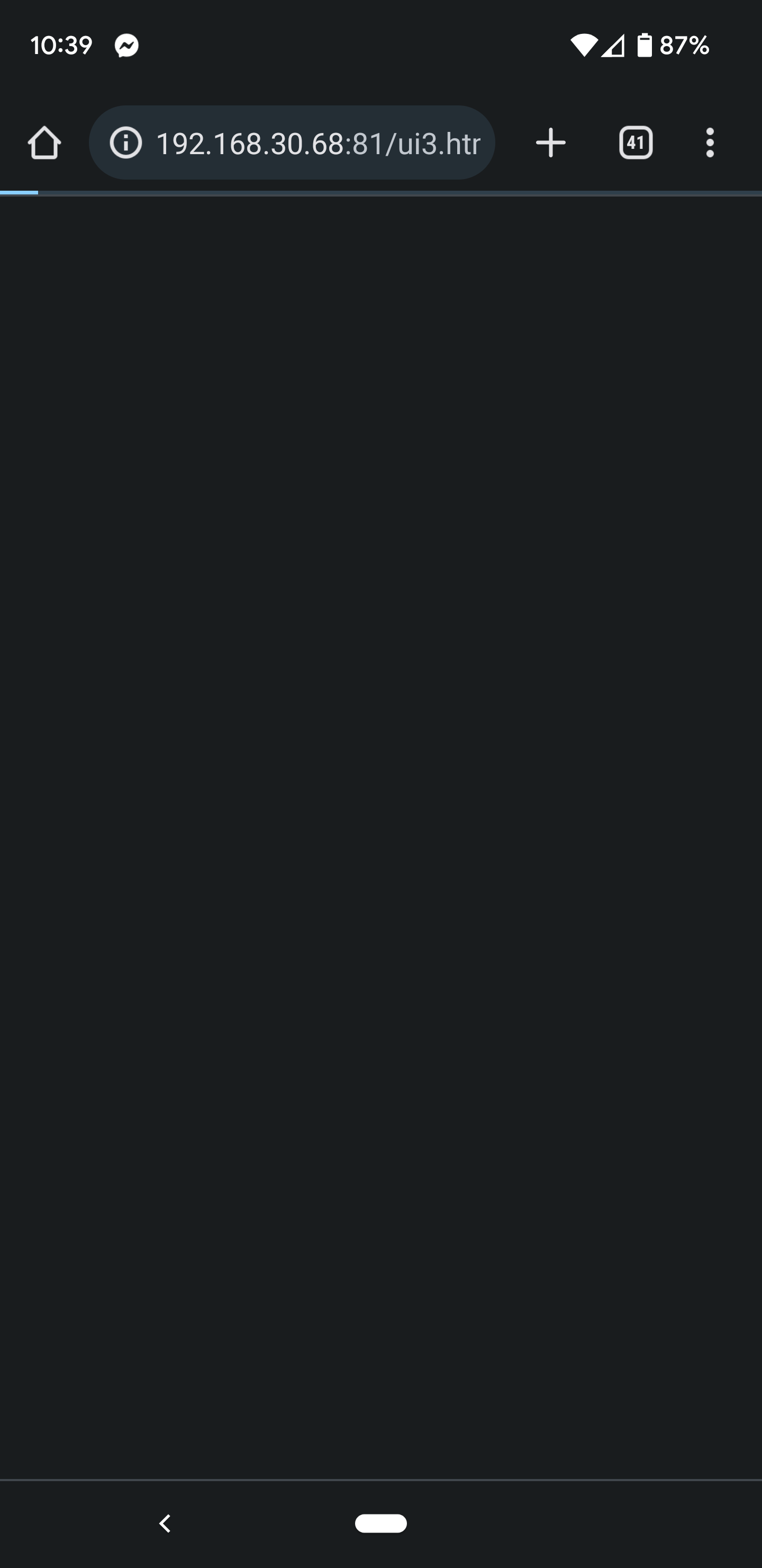

I have made more progress and thanks to everyone for the help thus far! I was having issues with curl and I guess pointing it in the right direction. I also changed &WAN to &LAN and now when I tap on the UI3 hyperlink it redirects me to UI3 but it never makes it to the login screen. More work to do I guess:idk:Screenshot_20220709-103910.png
