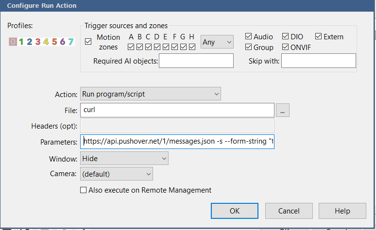

Ok as an update, I got pushover working via BI now with this command in the Trigger -> Immediate Actions -> Run a Program :
Code:
https://api.pushover.net/1/messages.json -s --form-string "token=secret" --form-string "user=secret" --form-string "message=<b>&CAM</b> &MEMO <a href='&LAN/alerts/&ALERT_DB?fulljpeg'>Hi-Res</a> <a href='&LAN/ui3.htm?rec=&ALERT_DB'>UI3</a>" --form-string "html=1"
However, if I add -F "attachment=@C:\BlueIris\Alerts\&ALERT_PATH" to the end of that command, I get nothing at all. I have Hi-Res Jpg files activated. I've also made sure that C:\BlueIris\Alerts\ is the proper path to the alert directory.

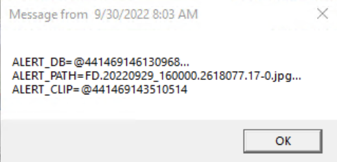

I just used my msg.exe trick to show the value of the macros.
And it appears that &ALERT_DB is now expanding already prefixed with @.
That would explain why you are seeing a double @@.
It appears that &ALERT_DB is now expanding already prefixed with @.
