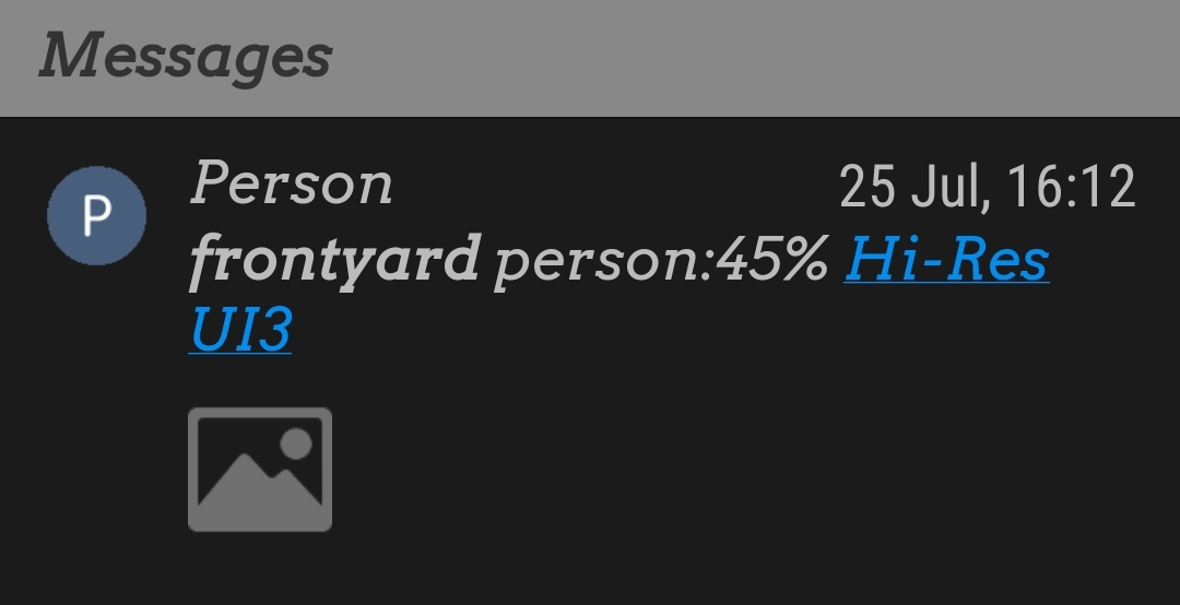

Got this working but sometimes the jpeg doesn't come through although the links work.
Why? Timing issue? Too many requests possibly? How can I improve it?

It’s a pushover thing. I’ve noticed it too. If you refresh/pull down they usually come through.

The Pushover API will drop image attachments that exceed 2500 KB. 4MP+ resolution cameras can produce images greater than the API limit.
If you are attaching hi-res JPG images, you can check if this might be the case by looking at the JPG file sizes in the Alerts folder for the affected cameras.

Yes they are high res but only 1920x1080 not 4k. I'll have a look at reducing the size though.
Telegram sends them without issues

I should have asked… Have you’ve tried tapping the image icon in the blank notifications?
The client app will try to download the image again.
It is my understanding that a successfully uploaded attachment will stay on the Pushover server until successfully downloaded by a client app. I think this might be true for every device specified in the API call.

Ah yes that does it. Duhh
If I click it and then go back to the channel it appears. Thanks!

Just had a thought. If you send the notification to multiple devices, and the attachment is not empty/blank on all devices, then the attachment file size probably is not the issue.
Yep thought about that earlier and reduced the numbers of devices which certainly improved the matter.
Just to chrome and my primary phone now
That's not really the point I was making, but I understand why you tried this.
You may find it ok now to go back to delivering the notification to more than 2 devices.
We're you seeing blank/empty image icons on every device?

Sorry yep just reread your post. In between my wife on the phone, son talking and watching prime
Wonder if it's related to firing off the alerts with jpegs to telegram and pushover at the same time

In my use case, essentially the only times I get consistent notifications that are missing the image attachment are when I am the person leaving the house, setting off a few alerts. I attribute those missing photo attachments to in essence a glitch that occurs during that brief moment when I am leaving my own wifi signal and my phone is transitioning over to mobile data (as well as trying to maintain a full-time OpenVPN connection back to my home router).
Meh, not really a big problem in my book, I could still download the images later if I truly wanted to.

You could be on to something there.
My house has several access points due to a lot of interference between floors and rooms.
I was walking around testing while those grey missed jpegs appeared.
I'll get my misses to test while I sit next to my 5ghz gateway
