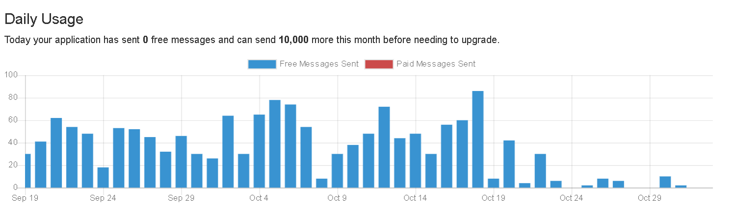

Right at the end of the October, my notifications being process dropped markedly, and all but stopped yesterday. The traffic at my gate has certainly not decreased, so I don't know what parm is missing or what update may have caused issues.
All was humming along nicely until now. And it's been so long since I set all this up (per the first post) that I don't recall how to properly troubleshoot. I know for certain though, that the triggers (IR sensor at my gate which has Home Assistant push http syntax to BI to trigger the camera) BI just fine. The camera triggers, but Pushover is doesn't know about it.
