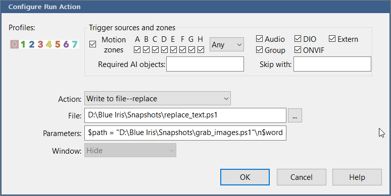

#1 is a 'Write to a file' action that creates a PowerShell script that replaces '@' character with '%40' in the URLs in the script created by action #2.

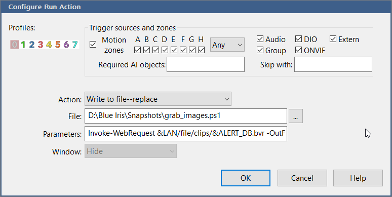

#2 is a 'Write to a file' action that creates a PowerShell script that executes the above mentioned Blue HTTP interface commands and saves the JPEGs to the hard disk.

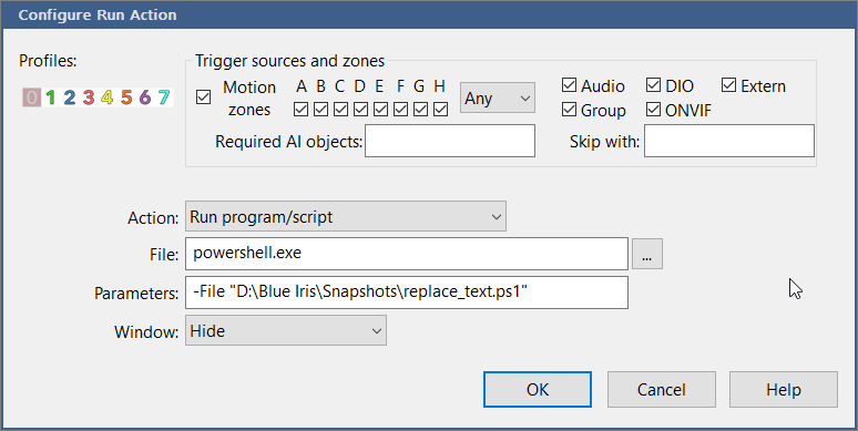

#3 is a 'Run a program' action that executes the script in action #1.

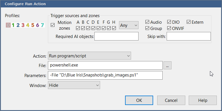

#5 is a 'Run a program' action that executes the script in action #2.

Screenshots:
Code:
Note: I've attached the code as a text file. This will make it easier to edit the path for the scripts and *.jpgs to match your system.
Code:
Action #1 - PS Script #1
File: D:\Blue Iris\Snapshots\replace_text.ps1
Parameters: $path = "D:\Blue Iris\Snapshots\grab_images.ps1"\n$word = "@"\n$replacement = "%%40"\n$text = get-content $path \n$newText = $text -replace $word,$replacement\n$newText > $path
Action #2 - PS Script #2
File: D:\Blue Iris\Snapshots\grab_images.ps1
Parameters: Invoke-WebRequest &LAN/file/clips/&ALERT_DB.bvr -OutFile "D:\Blue Iris\Snapshots\&CAM_leading_edge.jpg"\nInvoke-WebRequest &LAN/thumbs/&ALERT_DB -OutFile "D:\Blue Iris\Snapshots\&CAM_thumbnail.jpg"
Action #3 - Run script from Action #1
File: powershell.exe
Parameters: -File "D:\Blue Iris\Snapshots\replace_text.ps1"
Action #5 - Run script from Action #2
Parameters: -File "D:\Blue Iris\Snapshots\grab_images.ps1"
