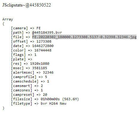

I've also been experimenting with the JSON clipstats command today...
When I use it to inspect the filename (&ALERT_DB) for a alert that with a hi-res image saved via the Trigger tab 'Add to alerts list' setting, I get the following output.
If I then use Windows Explorer to search for the highlighted [file] in my Purple drive 'Blue Iris' folder, it locates the file in the Alerts folder (as expected).
On the other hand, here's the JSON clipstats command output for a alert that WITHOUT A HI-RES IMAGE saved via the Trigger tab 'Add to alerts list' setting.
If I use Windows Explorer to search for the highlighted [file] entry in my Purple drive 'Blue Iris' folder, it CANNOT LOCATE IT.
Therefore, I conclude that it is not an actual file. I think it's just an internal descriptor for the database thumbnail image.
I note also that the value for the [filesize] key is different.

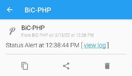

Here's the Pushover curl parameter code I'm now using in the Status Alerts action set...
Code:
https://api.pushover.net/1/messages.json -s --form-string "token=REDACTED" --form-string  "user=REDACTED" --form-string "message=Status Alert at %X [&nbsp;<a href='&LAN/admin/mlist?latest=100'>view log</a>&nbsp;]" --form-string "html=1"
As always, you can add device and sound args as desired.
Code:
 --form-string "device=galaxy-s21" --form-string "sound=cosmic"
The resulting Pushover notification looks like this...
