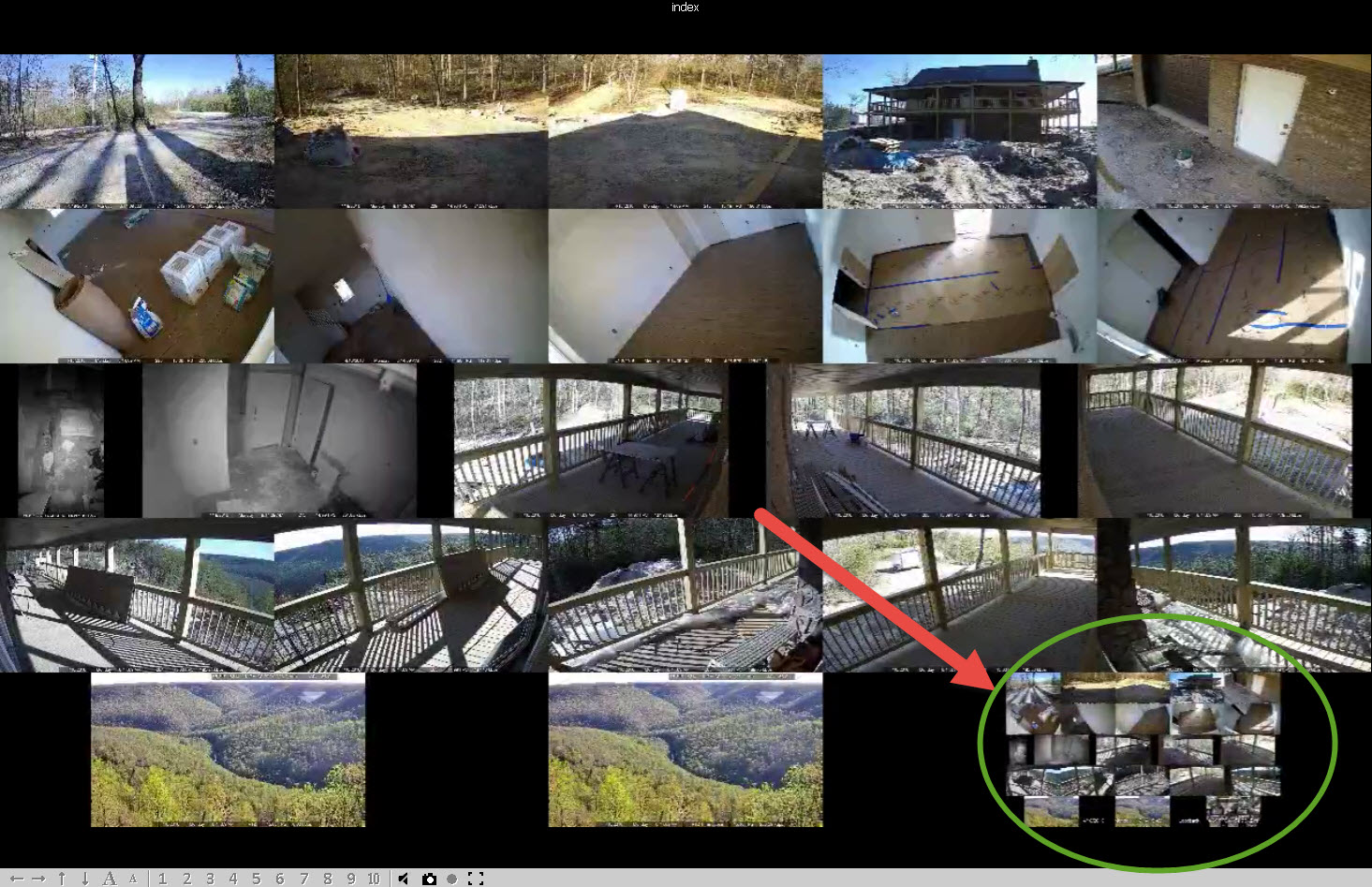

Is it possible to rearrange or resize the cameras, as it appears in the second screenshot of the first post? Or was that a screenshot of multiple instances of the viewer?
That was a screenshot of a portrait view 16:9 camera that had been clicked (bringing it to full-screen). To clarify, it is not possible to affect the layout of the cameras beyond what you have in the Camera Layout section of the options.
