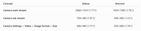

Just to add a little background from a couple of email exchanges I had with Ken over the past year...
One thing that wasn't immediately obvious to me is that Camera Settings > Video > Image format > Size is more than just a display of the camera's configured sub stream.
For dual-stream cameras, Blue Iris uses this value as an internal reference size. If the camera's sub stream aspect ratio doesn't match the main stream, BI automatically enables the Anamorphic option and adjusts the displayed width so the sub stream has the same aspect ratio as the main stream. For example, one of my Dahua cameras outputs a 704x480 sub stream, but BI displays it as 848x480 because that is the anamorphically corrected equivalent. The camera is still sending 704x480.
Ken further explained that this Image format size is ALSO used when Blue Iris decides which stream should satisfy an image request. Blue Iris appears to internally normalize the incoming streams using this size and aspect ratio, and if the requested image size is at or below this threshold, BI can use the sub stream; larger requests require the main stream. That seems consistent with what @bp2008 is describing here regarding UI3's stream selection.
That means this same setting has effects outside of live viewing. It influences the behavior of HTTP image extraction, and Ken mentioned that AI DAT images are resized independently (to roughly 480p) so they don't become excessively large. So this field ends up affecting several internal BI decisions, not just how the Video tab is populated.
One additional thought (my speculation, not something Ken explicitly stated): this architecture may also be why stream switching in the BI timeline is usually so seamless. Since BI has already normalized the streams to a common aspect ratio and working geometry, it can switch between sub- and main-stream frames without the obvious stretching or width changes you'd expect if it simply swapped between the camera's native 704x480 and 2688x1520 images. The net effect would be what we actually see -- the avoidance of visible discontinuities during timeline playback (disregarding text overlays, which do change with the source stream).
That same behavior may also explain why mixed-stream animated GIFs generated from BI clips with my PowerShell utility, BI_gif_tool.ps1, tend to transition smoothly between sub- and main-stream frames. The frames are already normalized before they're handed off for processing.
It took me a while to realize that Image format > Size isn't simply reporting what the camera is sending; it's an internal reference size that Blue Iris appears to use in several places.
So my takeaway is that the Image format > Size setting is really a central piece of BI's dual-stream architecture, rather than simply a display of the camera's configured sub-stream resolution.

That's a good question. I think it's auto-populated rather than purely computed. My experiments suggest BI actually uses whatever value is stored there, so changing it changes downstream behavior. What isn't obvious is why a user would normally want to override the automatically selected value.
One thing I've been wondering is whether BI intentionally targets a working height of about 480 pixels for many of its internal operations. That value seems to keep reappearing:
  • Many cameras default to a 480-pixel Image format height.
  • Anamorphic adjustment changes the width (848, 856, etc.) while leaving the height at 480.
  • Ken mentioned that AI DAT images are resized to roughly 480p so they don't become excessively large.
If that's the case, it would explain why the field is initialized automatically, yet remains editable. The automatically selected value is probably appropriate for almost everyone, but advanced users can override it when they need different behavior for image extraction or other processing.
I don't know if that's the actual design, but it seems consistent with what I've observed so far.
