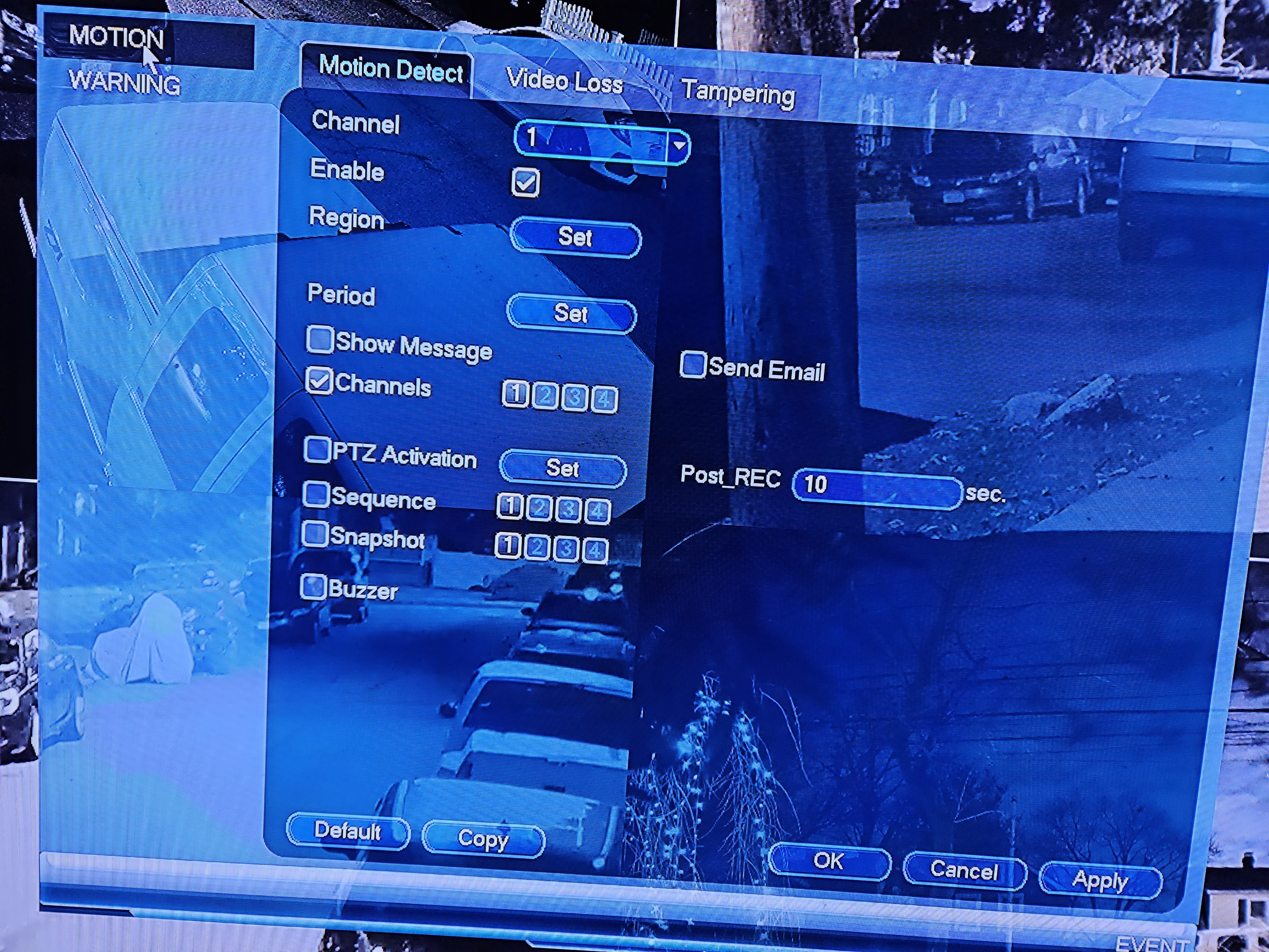

first want to say hello to everyone. I'm very much a newbie here. I've spent few days here in the forum trying to learn what I could. I 100% plan on coming back here and doing things full force forward but in the meantime I had a quick question I hope someone could answer. As for all this stuff you guys are doing, its being done thru BI, correct? Meaning if i wanted to setup a spotter cam, could I do this thru the camera's GUI? As mentioned I plan on building a sys that uses BI...but correctly I'm running on a lorex NVR. Thanks for any and all advice/tips
It cannot be done within the camera GUI - it needs to be within a VMS like Blue Iris or an NVR.
Take a look at the link on the first post - Lorex is made by Dahua and depending on your model, you may be able to do it within the NVR - my neighbor can with his Lorex.

The lorex I have is LNR6108. I dont think its possible with the one I own. To me it seems very hard to get it do what I want, compared to some nvr's and BI I seen on this forum, its made alittle easier to make it do what you want. What would I be looking for in the lorex nvr settings to see if it can do this feature?
I tried looking myself for where this option to allow me to use a spotter cam might be and not sure where it is...the only thing I found that might be helpful is this picture. Please let me know if this is what you guys are talking about. Also I called Lorex and asked them if their system could do this and they said no. I spoke with a supervisor in their tech dept. I first asked if mine could and if they had any NVR that could and he said no but said it was great idea and will pass along so they could maybe include it. I know it is possible cause wittaj said his neighbor can but might have different ver NVR.
So if someone can please take a sec and look at pic and or check out the NVR ver I have and confirm if it can do this. As mentioned I tried calling tech support for the help but it was waste of time. Thanks in advance
Looks like your NVR doesn't have IVS rules?

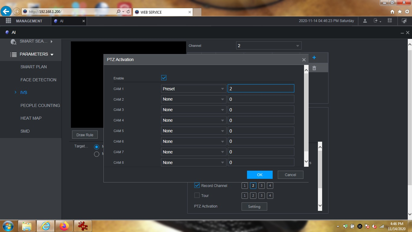

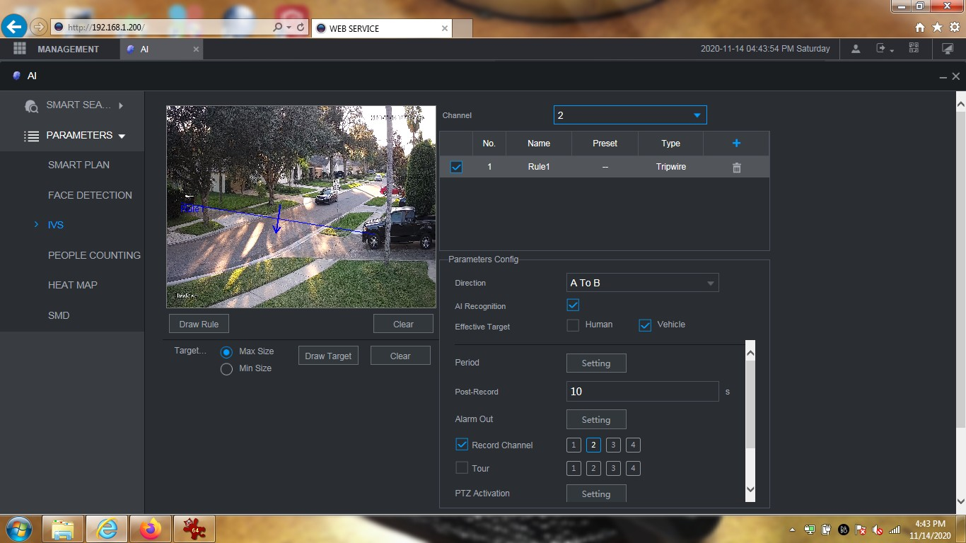

From the link in the first post for a Dahua OEM NVR:
Preset #1 is the “home” preset
Preset # 2 is the scene you want the PTZ to move to when commanded by the spotter
-On the NVR go to AI
-Then choose "Parameters" and IVS and go to the spotter camera IVS rule
-Go down to "PTZ Activation" and in the popup choose the PTZ on the left list (cam 1 for me) and enter the number on the right of the PTZ Preset you want it to go to when the IVS rule on the spotter cam is tripped (Preset 2)
