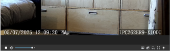

This is just going thru my NVR. Looks like it's easy to set up a preset without messing with the cam gui.

The view is about mid range of the optical zoom. I could zoom much further in if needed. I'm happy with this cam but if you don't mind paying a bit more, you can get more. (this is not a complete set up) just 1st day of playing around. This is also not an ALPR cam. your millage may vary....;)

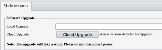

I found a firmware update and can confirm that it works. These are the same camera as a Uniview IPC_262ER9-X10DU. Mine had firmware from 2016, and I was able to upgrade to firmware from 12/2019. The latest firmware I could find is IPC_Q1201-B5029P12D1907. You can find firmware and release notes here:
Download center | Discomp
Interesting. I have 2 of the Vigilant units, so I installed IPC_Q1201-B5029P12D1907 on one of them. Mixed bag:
  1. Firmware updated successfully, and the updated unit reports version IPC_Q1201-B5029P12D1907.
  2. The camera did prompt me to enter a new password upon first boot.

More interesting-er: I clicked Cloud Upgrade: Detect, and now:
I didn't get a chance to confirm/cancel; it just said, "The upgrade will take a while. Please do not disconnect power." :wow:
I'll let it simmer for an hour and see if anything changes.
When I click Cloud Upgrade on my other unit running the older IPC_Q1201-B5025P20D1806C17 firmware, I get "No version detected for upgrade."

Actually, clicking Cloud Upgrade: Detect once doesn't actually execute anything. I just checks. Once it displays the above message, clicking Cloud Upgrade a second time results in:
I clicked OK, and after 5-10 minutes, I now have firmware version QIPC-R1201.30.42.220623 and a slightly different UI:

Do these camera have a mic and does it work? I've never tried it since I use it for LPR.
Yes! The new firmware now includes a volume control on the Live view:

Actually, clicking Cloud Upgrade once Detect doesn't actually execute anything. I just checks. Once it displays the above message, clicking Cloud Upgrade a second time results in:
