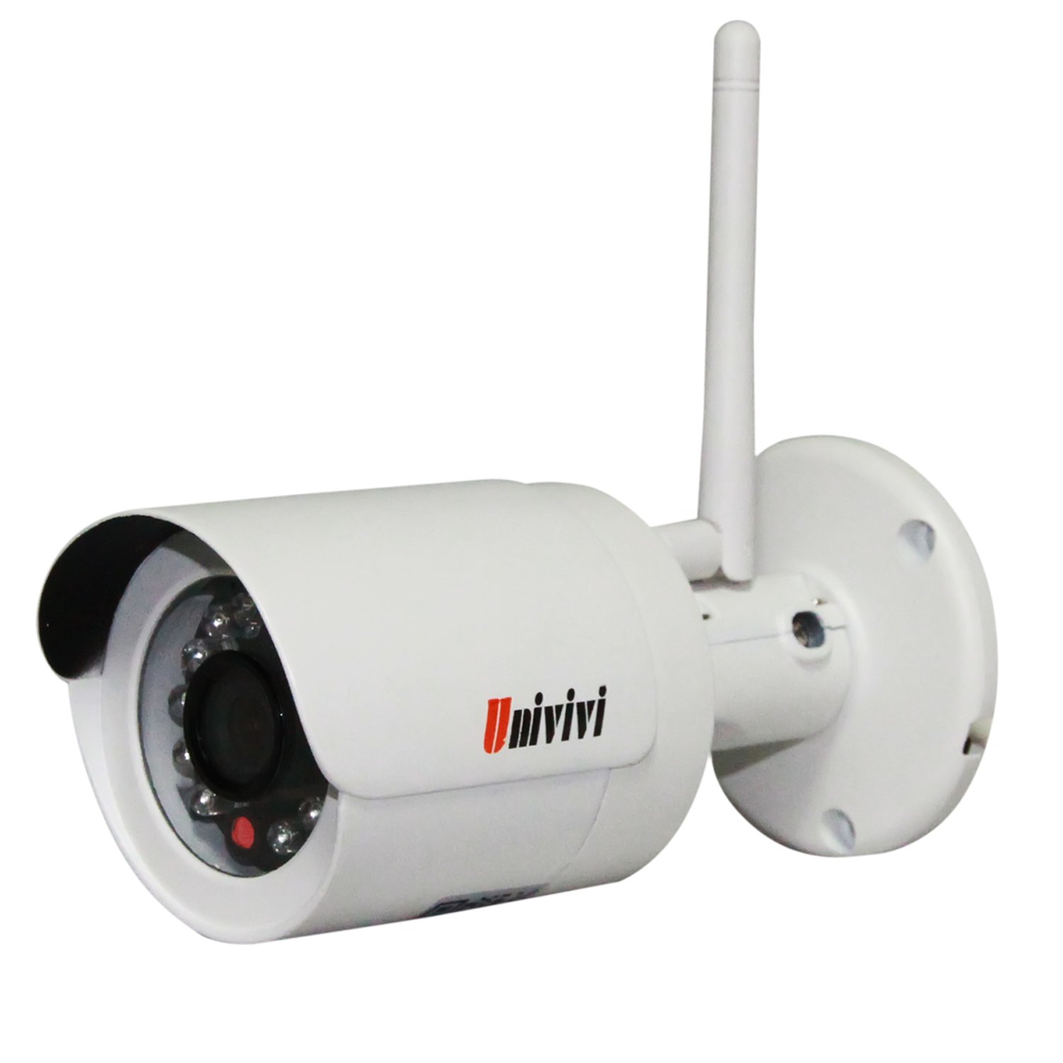

Hello ,
I currently have a Univivi U611W Megapixel HD 1280 x 720P H.264 Home Security Surveillance Indoor/Outdoor IP Camera,WiFi spy camera,Wide Viewing Angle, Night Vision 30ft with IR-Cut support Andriod and iOS (white)
The night vision is a total white out. The software has a place to turn off the ir led - but it does not function. I like the size and day time picture of camera but wish to trun off leds. Does anyone know the Clone of this camera? Thinking an firmware update may provide the useful functions?!?

post a picture of what you are seeing at night.
ok..looks like really bad ir reflection...can you post a photo of how the camera is mounted?
That is pretty bad.
I see two possibilities.
1. Something near the front of the camera is reflecting IR strongly back at the lens.
It should be easy to rule that one out just by looking up at it. If it is under an eave then maybe the edge of the eave is just out of sight and it could cause this. But usually when this happens you get more of a ring shape in the picture. Your video looks more constant.
Second possibility: The IR is reflecting off the internals of the camera and making its way back to the imaging sensor. Maybe through the lens, maybe through a gap between lens and sensor. You can often fix this by opening up the camera and adding black material around the lens and all the way back over the sensor. Black tape for example, or even a black piece of foam if you have some handy. There is not a lot of room to work with. If all else fails, you can open it up again and unplug / cut the IR leds. The thing I would worry about is that the light sensor is there on the IR board and if you disconnect it then the IR filter will probably not function and who knows what state it will be left in.
The Camera is mounted straight out. Under eve but clear of anything else. Yes I wanted to turn off the IR Led just for that reflection idea. I have changed the mounting tilt without luck.
