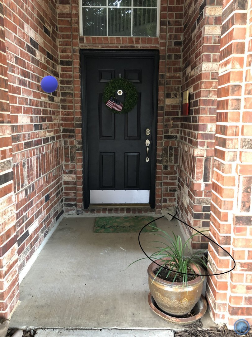

Front door ID camera IPC-HDBW4231F?
Hey @looney2ns my front door is over 8' tall!
I'm going to go under the house this afternoon I think and I'll take a closer look at the doorbell wall. I don't recall how much the concrete slab interferes. Thanks for the advice on the optics and time for testing.

Still maybe worth a test depending on the distance from doors to the steps.
I'm also just wondering if or how soon I'd regret a dome here...
Hi Team,
Looks like a good location, some good shade, if you keep you porch light on - I would definitely go for the mini-dome wedge 4231 there.
With a camera mounted near the doorbell people almost always look straight at the camera whether they know it or not. I've had delivery people look into it and wave. I've had people look at it with blank stare. Anyway they're looking directly at it and that means good ID : )
That was a wild quick pass guess, scratch that. :)
Yes, definitely still a test. Hopefully this week.

I have a dead spot between my 2 garage doors that I can't cover from the soffits on either side. I'm thinking about mounting the IPC-HDBW4231F at the top and between the two doors as the 5231 does not pass the WAF for mounting on the face of the garage. Is this camera WP enough to be mounted to a flat wall with no cover above?
The IPC-HDW4231EM-AS is a little smaller (still a turret) IPC-HDW4231EM-AS | Dahua Technology
The IPC-HDBW4231F wedge is IP67 rated just like the turrets, but you'll have more issues with the dome especially if its in full sun.
Would you get the 2.8 or 3.6 for this front door location? OK to mount on the side wall (abuts to garage, so could come through that wall directly behind camera)?
I would go with 3.6 for the best ID for someone coming up to the door. You also likely need to run back light compensation.
Will the 3.6 be able to capture both the person coming up and the package on the ground? Do you think it is OK to mount on the side wall? Thanks!
I could always use the IPVM calculator. IPVM Camera Calculator V3
Definitely want run in Corridor mode.
Make sure you go back to the very beginning of this thread read through it look at my pictures.
They never put the packages where you want them anyway usually they chuck them right by the door so there's no way one camera is going to get both the package and person at the same time.
Hi @iseeker
I would try to place it as close to the front door as possible at about face level so that you can get a straight on facial ID image.
I have a 2.8mm lens, and it works well for those right in front of my door. However, if you place a package close to the foot of the door I will not see it. So you may want to look at the dual lens version as a camera for that location.
