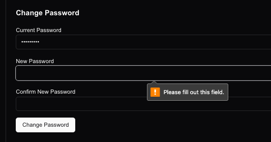

Edit: @algertc is there anyway to eliminate the required login password? I tried entering a blank password in the security settings but it didn't work.

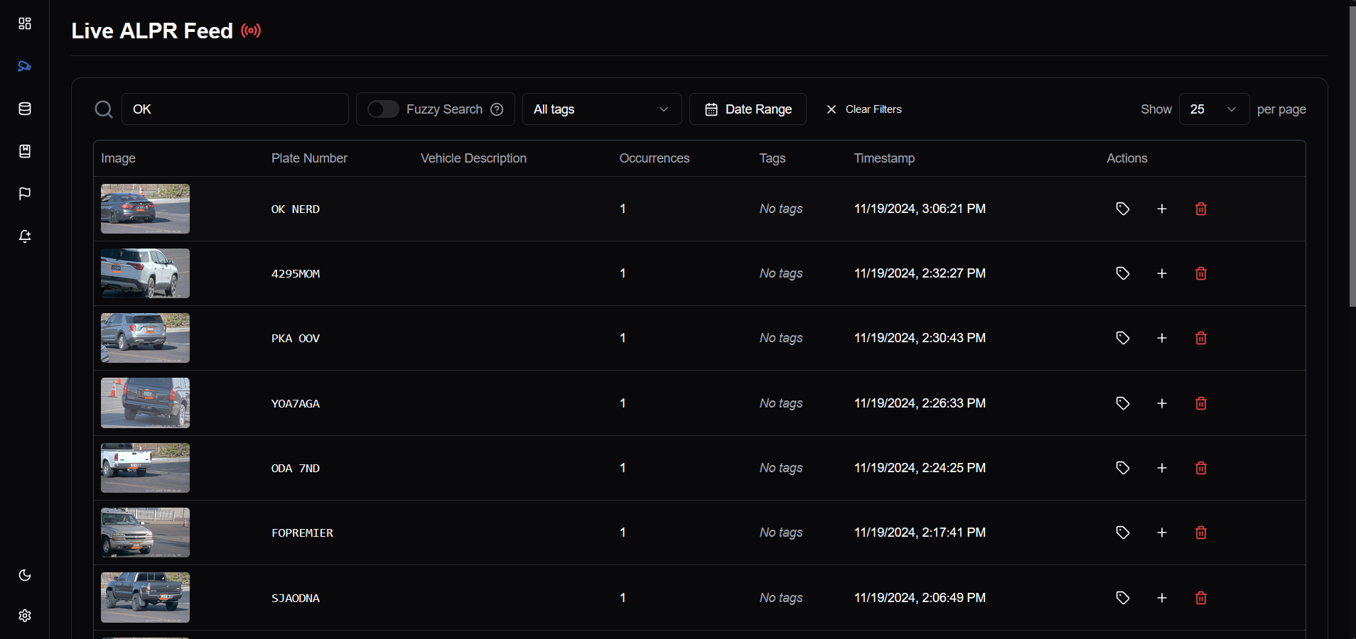

This is awesome! Thanks for sharing!!

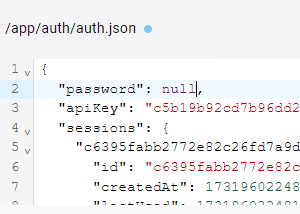

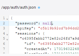

Not sure if I would recommend it, but you should be able to do this by going into the auth.json file (the one in the persistent volume at /auth/auth.json) and setting the password hash to null. (password: null,)
It's definitely not the most secure, even with the password. I should probably switch it over to use HTTPS if people are going to use it.
Anyways, give that a try.
Changing the password option to null didn't work. The dialog box still appears prompting a password. Entering a blank password creates an invalid password error

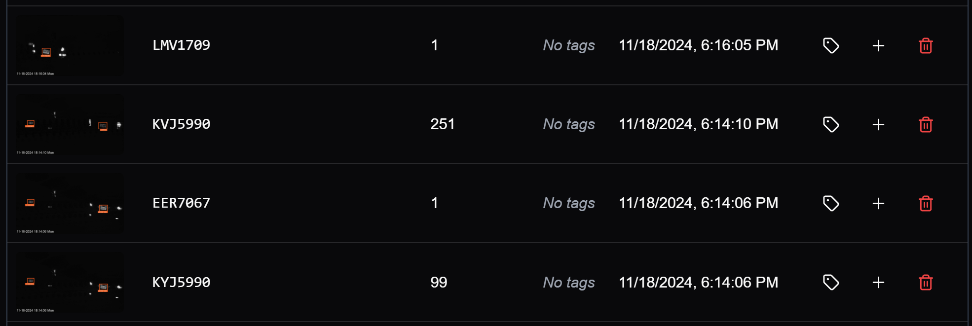

It looks to be working most of the time. Below is one instance where it did not 11/18/2024, 6:14:10 PM had two plates but only recorded one. At 11/18/2024, 6:14:06 PM there were two plates and recorded two plates. Plate KVJ5990/KYJ5990 is a parked car.
Here is the payload for the missed plate
{ "memo":"EART:70%,KVJ5990:90%", "Image":"&ALERT_JPEG", "timestamp":"2024-11-18T23:14:10.862Z" }
Hmm. “EART” nice. I used a regular expressions solution to filter out all the other AI objects that I thought was pretty clever at the time, but it will not work for a short vanity plate like that.
I think the best solution to still be able to handle vanity plates is going to be to create a wordlist of every single other AI label that might come from any of the models people are using, then check against that.

The plate was not a vanity plate it was just distorted and read incorrectly. I will make a list of all of the AI labels that I used for my models and for the YOLO models
View attachment 207549.
Alright, so it turns out I don't have a great way to turn it off without changing the way it works and adding it as a setting, which I would prefer to avoid.
Can I ask why you want to remove it? Right now it should only make you log in every 24 hours. If this is too much of an annoyance and a longer session like every 7 days would be better, I could add something to allow you to set that in the config. It should also let you save your password in your browser and try to autofill it so you don't have to type it every time.
