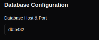

Your DB port is wrong. should be 5432, not 5433 (unless you did that intentionally)
that is correct port and it connects to the DB ok

Okay, looks like it is running but not sure why you have 5433 to 5432 port mapped. I run a few different instances of ALPR and by default, none of them do this. I'm on Linux, so maybe this is normal for Windows.
this is running on debian 12, i picked 5433 because years ago i had a testbed on 5432.

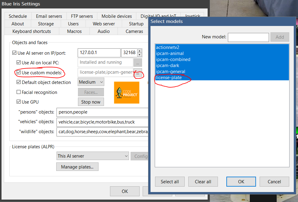

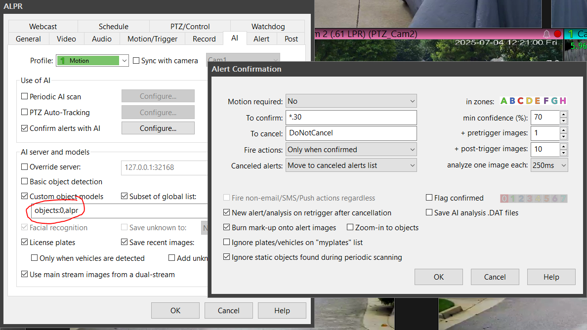

This might help.
