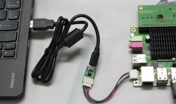

This looks like it may be what I'm looking for, its all in one usb serial connector:http://ameridroid.com/products/usb-uart-module-kit2 . Any thoughts?
MTkxNkIzRTAwMENBREFDNEUyM0I6NTUwZDNkYmRlNGNiNDc5MDM0NDQxNTE2YTI0Yzc2OGQ6Ojo6OjA=
That doesn't look like the right connector, the Molex5268-04 connector is listed as a 2.5mm pitch, the one needed is 1.5mm

Yes it's a JST ZH 4pin connector with 1.5mm pitch you need
Thanks for that information about the 1.5 mm pitch, I'm trying to locate one, any suggestions?

Where are you located?
If your in the UK I've got loads!
If not try eBay
Ali express sell them in 10's the are labelled as micro jst connector on Ali express
