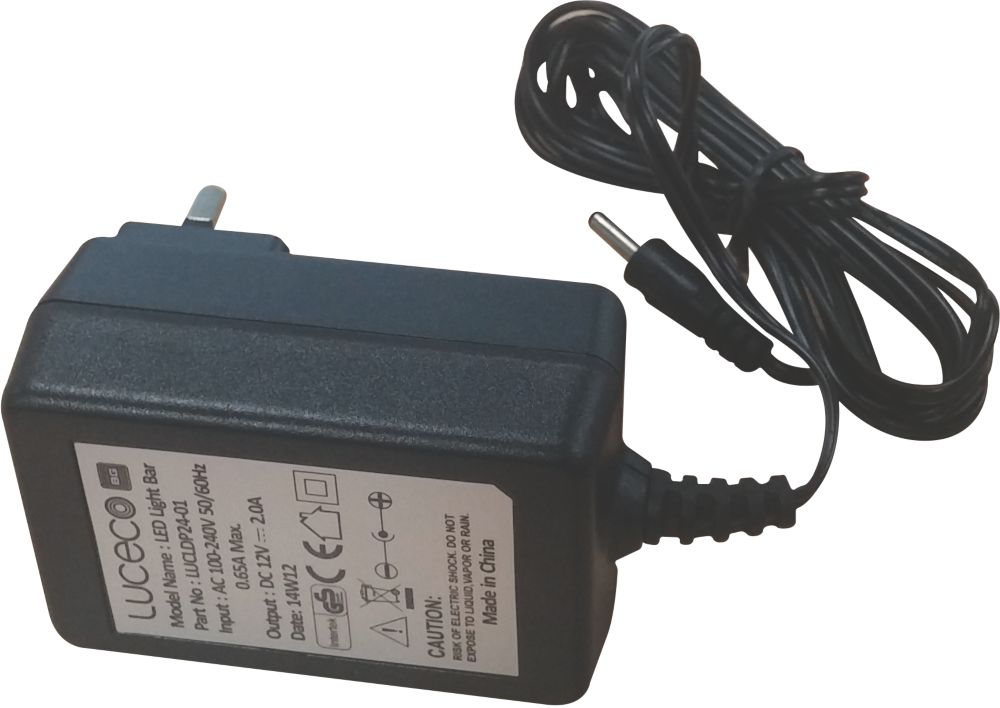

Considering a slightly more powerful transformer to avoid the buzzing I'm currently getting (it's like we've got a neon light fitted). Anybody think this one would be appropriate: Robus Electronic Transformer 35-105VA
It seems to be 12V way more current. Its designed for light fittings but should work I guess?

I'm not sure if the dimmable aspect of those light transformers would play nicely with the doorbell, a regular 12V power supply would be fine, just needs to be plugged in instead of hard wired.
