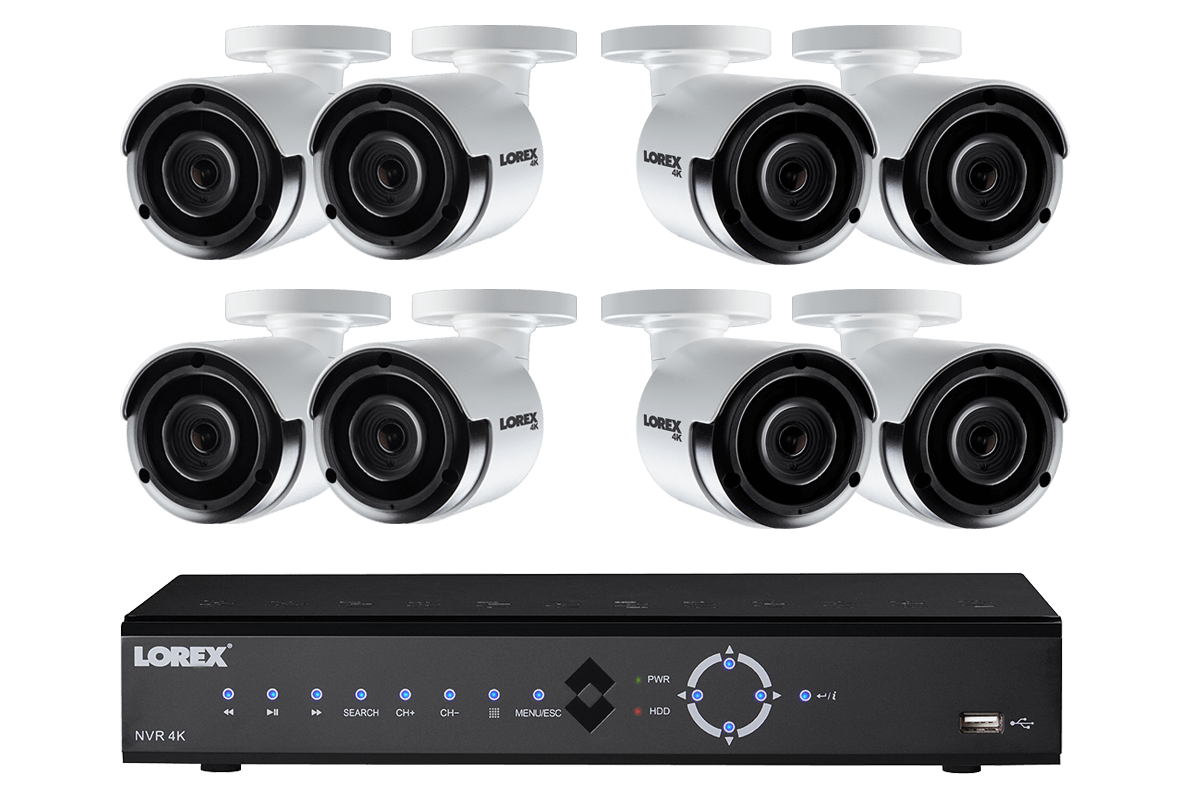

Hi All - I'm totally new here, but it sounds like you all would be the perfect people to ask this question. I'm looking for recommendations on a 16-channel NVR...
Backstory:
On Prime Day a couple months ago, I snagged an 8-camera 4K Lorex system for six hundred bucks. Not being super familiar with the brands but (perhaps wrongly) wanting to avoid fly-by-night brands, I thought a Lorex system would meet my needs - it was 8-channel, and although I wanted a 16-channel system even though 8 would meet my needs, but beggars can't be choosers I guess. I went through the back-breaking labor of doing the Cat5 runs through my attic, trenched in a Cat7 cable so I could grab a good view of my property from the corner (PoE injector & access point in the shed), and I thought I had a decent system set up.
The cameras seem excellent with very good night vision, and despite not listing it on the Lorex website, the cameras seem to be ONVIF-compliant (I can connect directly to a camera using an ONVIF-viewing app). The Lorex NVR, on the other hand, is THIS CLOSE to getting thrown out the window! The app is clunky, I can't do a lot of the configuration remotely (not good as I wanted to seal this system in a semi-permanent location), and it has just become a hassle! The worst, though: I spent days configuring the motion detection zones for my cameras, labeling them, setting up recording schedules, etc. Well, I had to turn off the power to my house for a few hours to do an unrelated wiring project, and when I turned the power back on, the Lorex system had lost roughly 90% of my configuration! All my motion detection zones, all but one of my camera configs, all my recording schedules - GONE. I was absolutely sure to diligently save all my config changes, so there is seemingly no reason for this. Along with that, two cameras can't connect to the NVR now and are getting wacky IPs issued to them despite being directly connected, but I can't even dig into the networking config because the Lorex Client is so limited. Even if I could get the NVR's config back to where it was, the loss of my time is what I'm really mad about. I am DONE with this NVR!!!
I want to ditch the NVR but keep the cameras. Since they seem to be ONVIF-compliant, I'm going to steer clear of Lorex and get a better brand of NVR.
This was the system I bought:
What I'm looking for:
A 16-channel NVR that has 4K and H.265 support. I would be fine with no PoE ports on it as (being a network engineer) I'd kind of like to buy a PoE switch separately and stick all the cameras on my LAN. I also don't need an included HDD as I may canibalize the 2TB from the Lorex or potentially buy a bigger drive, but I wouldn't turn away one just because it came with a drive.
Mobile app support with motion detection zones is a must, and being able to configure the thing almost entirely remotely would be strongly preferred.
$500 would be my limit, but I'm hoping not to spend that much as I'll be dropping cash on the PoE switch.
What am I looking for? A Dahua box?
Any help would be GREATLY appreciated!

Lorex is a Dahua rebrand, so there will be a lot of similarities in NVRs.
If you set the settings within the camera GUI and not the NVR they will stick.
Have you tried the Dahua app instead - iDMSS for apple or gDMSS for Google. Not perfect, but probably easier than the Lorex app. My neighbor has the Lorex NVR and once I showed him these, they are all he uses.
Personally I gave up on NVRs because I have found them to be clunky and a struggle to review clips, just as you are finding. I went to Blue Iris on a dedicated machine and haven't looked back. Not all NVRs are created equal - your NVR is probably limited to 80Mbps bandwidth and probably limits cams to 4096 bitrate, so once you look at an NVR that can pass a higher bandwidth, the dedicated computer and Blue Iris was cheaper in my case. Pros and Cons to each and many people on here run NVRs successfully.
With Blue Iris, you can remote desktop in, use teamviewer, etc. to get to the unit from anywhere.
I strongly consider you read up on Blue Iris - you mentioned being a computer person so I think you would find this exactly what you need.

Hi @JessieO
I have taken a closer look, that kit is not a Dahua OEM NVR
If you wish to keep the cameras and you think they are ONVIF, I would go the Blue Iris Route.
Specs:
NVR pdf
Camera pdf
Compatibility page: Lorex - Product Compatibility Chart
Camera LKB383A is reported to only be compatible with the LNK7000 or LNK7000X NVRs, it is not reported to be compatible with the known Dahua OEM NVRs.

Sounds like I'm leaning toward the Blue Iris route. I've got a laptop that I can use as the PC, PoE switches are so reasonable these days (and I'd like to manage the cameras' IPs via DHCP reservations on my network), and I can plop the hard drive into a USB dock. Tearing down the cameras and returning the system isn't really an option as too many consumables from the kit were used during the installation, and even if I could get my money back, I spent too many hours rolling around in fiberglass insulation to want to take out those cables. All of this is OK - I went specifically with a IP-based system with cat5 cables so I'd have the flexibility to upgrade, add, and replace components down the road as now the cabling infrastructure (the hard part) is there.
As far as my loss of config on my NVR, all of my configuration was done via the NVR's web interface. I was very diligent in properly saving each change to the config after I made it as I had previously lost a few settings by not hitting "save" after each change.
The NVR sadly doesn't have a way to safely shut it down via the web interface or the client, so all shutdowns were "hard" - it feels very wrong powering it down like that, but I searched and searched for any way to shut it down remotely, and there doesn't seem to be a way. The NVR is plugged into a UPS, but I live in such a rural area that an NVR that cannot tolerate the occasional power outage just wont work for me as power is not anywhere near as stable as it is in the cities.
