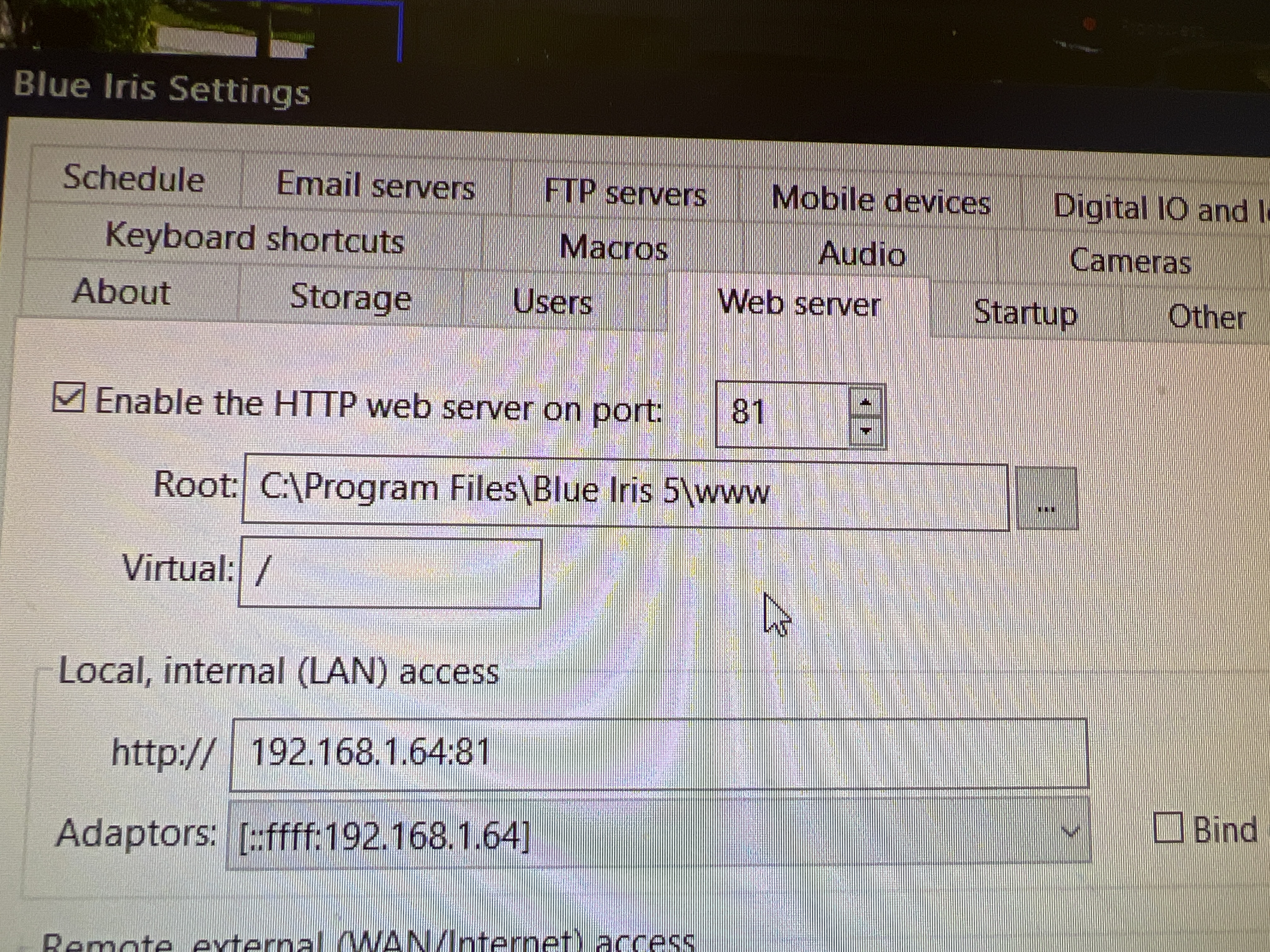

The port is included already, see screenshot. I’m trying to force it open in Chrome but you can see the http:// is not changeable on the web server tab. Although I’m not entirely sure if the &LAN adds it or if it pulls it from that field.
I can access ui3 fine from Chrome. I’m just trying to be lazy and have the link open it from pushover without changing the default browser to chrome.

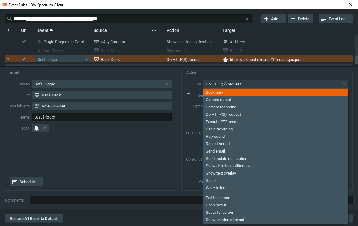

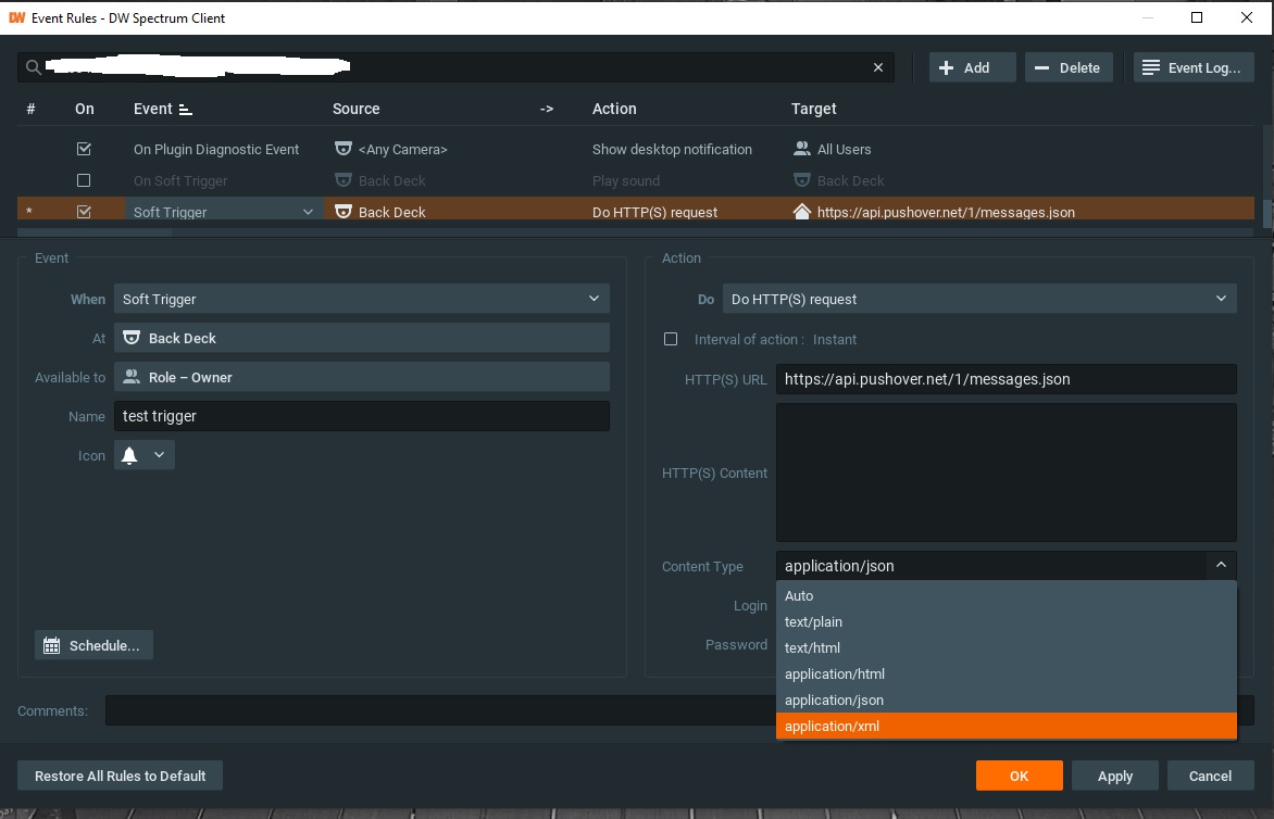

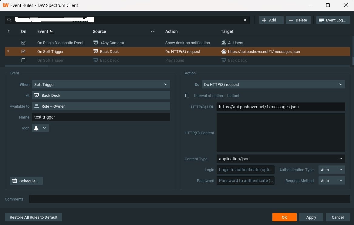

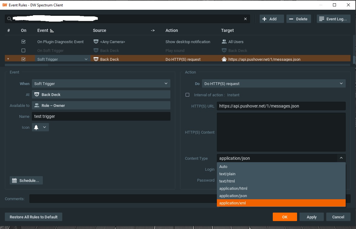

@jaydeel I'm attempting to setup pushover notifications using Digital Watchdog. DW has an option called Do HTTPs request and it can be activated upon an analytical event trigger. I've tried a number of combinations and I've also read Pushovers API page. I just can't seem to figure it out lol. All I'm trying to do at this point is get DW to successfully send me a pushover notification which only includes a simple message like "test". DW has a feature called "bookmarks" which is similar to BI's alerts. Once I get DW to send a successful Pushover then I'll figure out how to grab the bookmark image. I've included my token, user and message in the link. I think I'm just not typing it in properly. Assuming I continue the line in the HTTPs URL field, how would I continue it after "messages.json'"? Do you have any suggestions?

I made a cursory, unsuccessful attempt to find a user guide for your software.
Does DW have an option to send a curl command?
If not, how about to run a program/script? If affirmative, here’s a basic PowerShell script I previously posted that you might find useful for testing.

No, only option is to do a HTTPs request. I attached a picture with all of the options.
If not, how about to run a program/script? Here’s a basic PowerShell script I posted for testing.
I made a cursory, unsuccessful attempt to find a user guide.
The email option works, I was just hoping I could get it configured where I could send it directly to pushover without having to use an email address and have a bunch of emails in my "sent" folder. Worse cause I will just use the DW app for push notifications. Only problem is I can't change the sounds on DW app and I like the distinctive sound of the pushover alerts.
