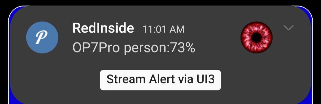

It only works because theye!!! got it working, All i did was move this to the beginning- --form-string "priority=1" instead of the end
Here's the syntax that's working well now and it's showing the alert with a red box around it on the app
Code:https://api.pushover.net/1/messages.json -s --form-string "priority=1" --form-string "token=%996" --form-string "user=%997" --form-string "message=<b>&CAM</b> &MEMO" -F "attachment=@C:\BlueIris\Alerts\&ALERT_PATH" <a href='&WAN/alerts/&ALERT_DB?fulljpeg'>Hi-Res</a> <a href='&WAN/ui3.htm?rec=&ALERT_DB'>UI3</a>" --form-string "html=1" --form-string "device=%998"
