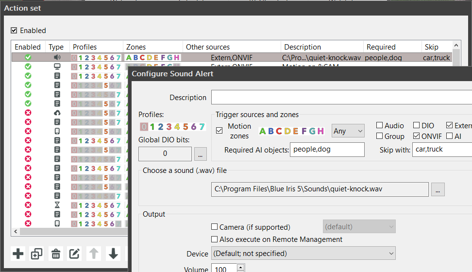

Please forgive me for my ignorance. But when you say blue iris action what does that specifically mean?
Example:
Camera settings > Alert tab > 'On alert' button > displays an 'Action set' dialog
Each entry in the 'Action set' is an 'Action'
The screenshot shows the dialog for the 1st Action in the Action set
Example:

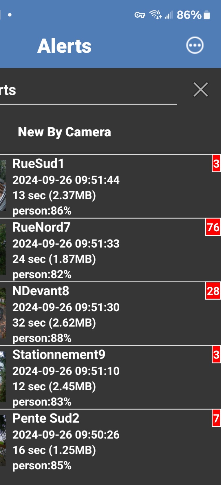

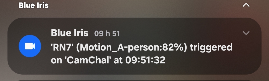

All my cameras have been setup for Pushover as described in the posts found in this very instructive thread. Went for a walk around my backyard.
Photo 1 : The screen capture of the detections made by BI that are shown on the BI app
Photo 2 : The only alert received on my phone
Question : Is photo 2 showing an alert from BI app or PO?
Photo 1 : The screen capture of the detections (All good) made by BI that are shown on the BI app
Photo 2 is a Blue Iris notification.

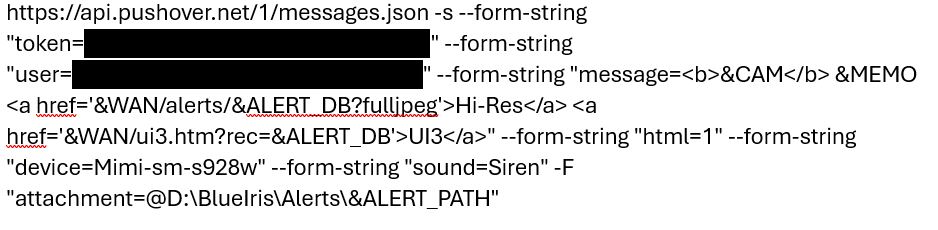

Did you confirm that the Pushover app on your phone is receiving notifications when sent from your Blue Iris PC via the curl command in cmd.exe? See section Testing using the Windows Command Prompt in post #1.
I did the test suggested in post #1 and did not receive anything on my phone. So something is not right somewhere.
Any clue?

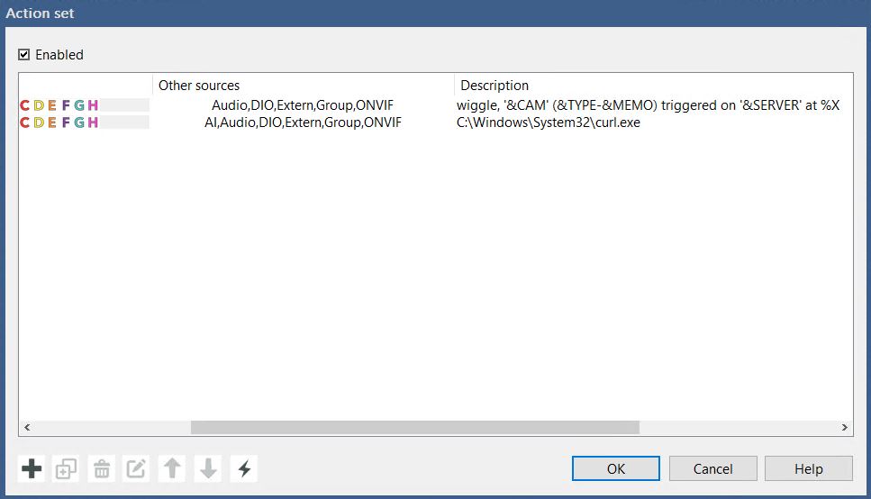

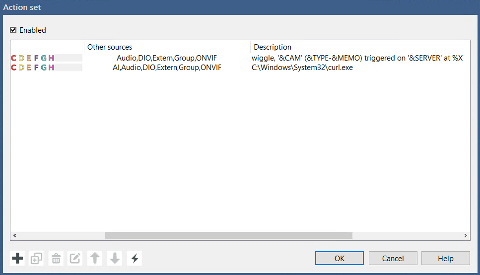

Photo 3 and 4 : Capture of Action Set parameters

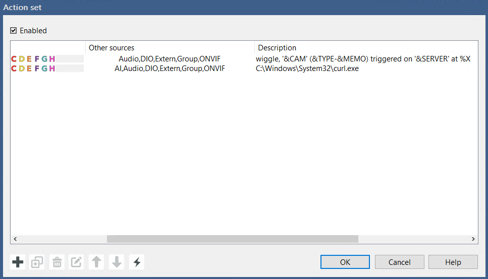

Photo 5 : Parameters in Configure Run Action
Any clue?
You need to share the actual command that you are testing in cmd.exe. Not a screen grab of cmd.exe, but the actual command text, preferably in a code block.
I did C:\Windows\system32>curl.exe and right here the text found in picture 5 of my preceding reply
If you are using the exact text in your picture 5 to execute the curl command in cmd.exe, then it will fail.
Key Points:
  1. The Blue Iris macros are expanded only when executed via a Blue Iris Action. In cmd.exe testing you'll need to replace them with actual values.
  2. The -attachment= argument must point to a JPG file that actually exists in your Alerts folder.
Reactions: looney2ns and Oneup
