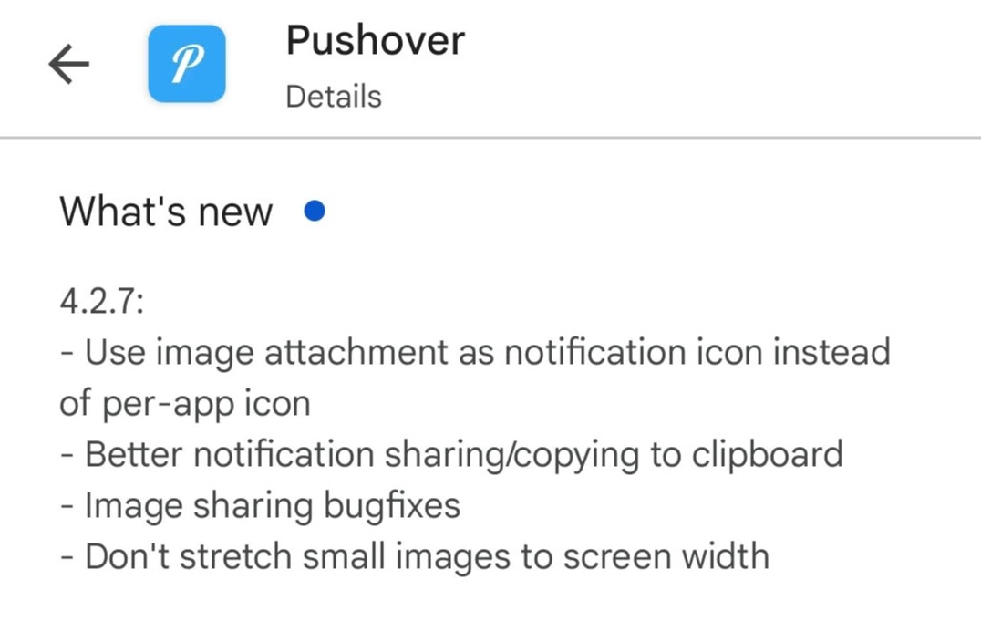

My pushover app on the phone updated and changed the sizes of the images, maybe the update on the phone did something?
The Pushover Android app version 4.2.7 made a change to not 'stretch' small images to full screen width. It also broke auto-playing of GIF attachments (a major impact on the usefulness of my bi_gif_tool.ps1 script).
I emailed the developer and he never responded.

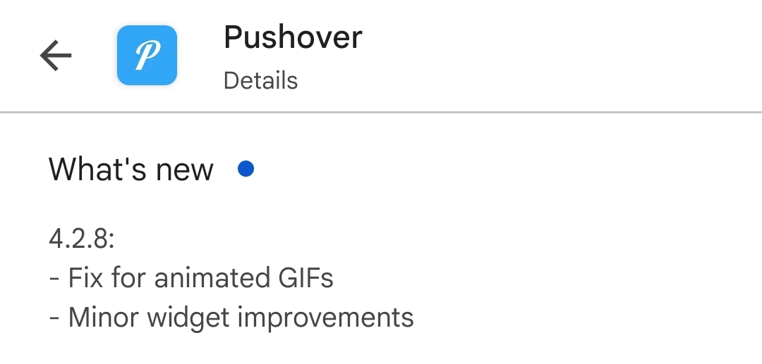

But just today I see the following 4.2.8 update in the Play Store.
I'm starting to test it now.

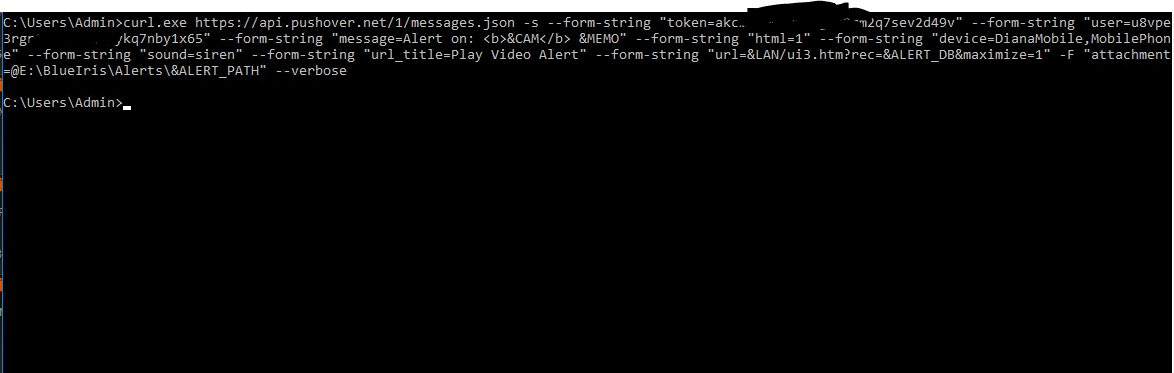

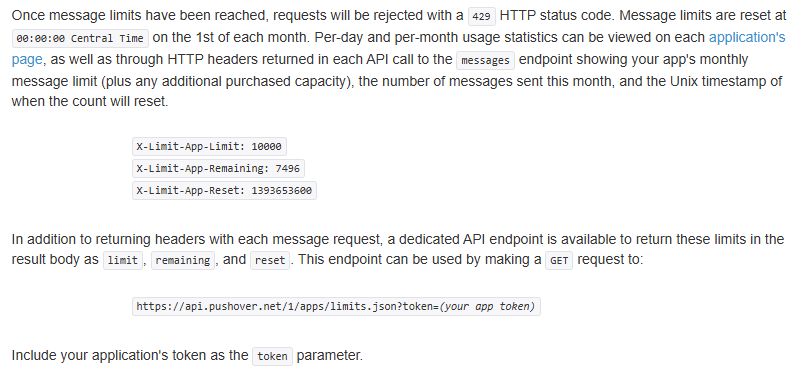

The API page has the following info... perhaps you can try executing the curl command in cmd.exe and investigate the response.
If you get the 429 status code, it might mean that the service THINKS you've exceeded your 10,000 message limit this month.

Regarding the 4.2.8 update of the Pushover Android app...
I'm pleased to report that this update has restored the former handling of GIF attachments:
  1. GIFs now play automatically, and
  2. Small GIFs are automatically 'stretched' to the width of the app window.
I was not looking forward to taking a performance hit by having to increase the size of GIF's JPG images, and consequently increasing the size of the GIF file.

If Wittaj's reboot suggestion doesn't solve it, then do give the cmd.exe execution a try - with argument --verbose.
See post #1 section "Testing using the Windows Command Prompt".

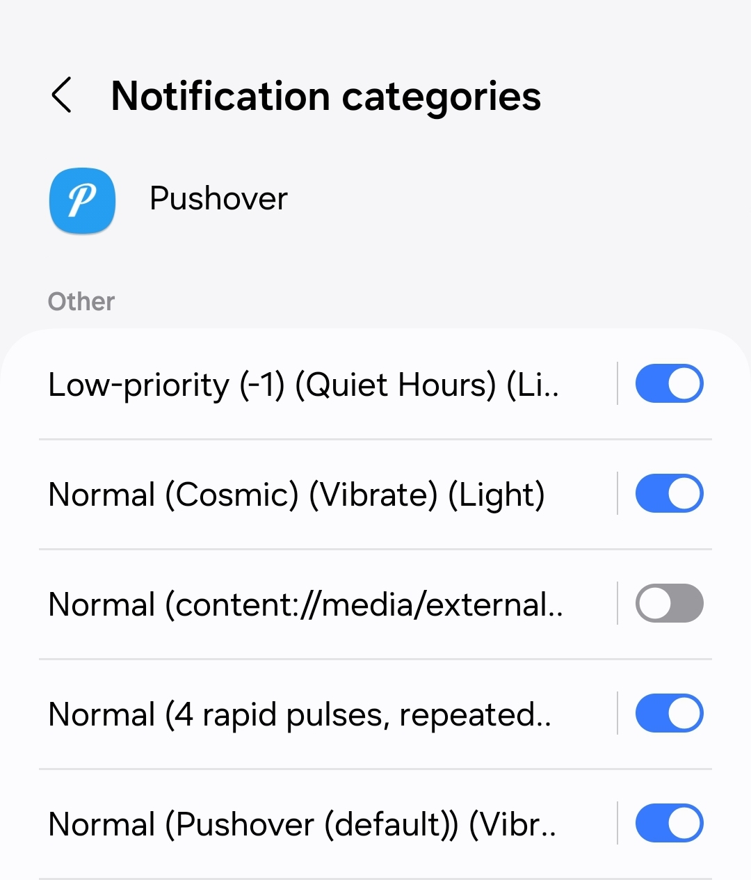

And check the Notification settings for the Pushover app on your devices. Perhaps a category has been inadvertently created or disabled in the 'Notification categories' section.
That would not explain why pushover messages from parents systems comes in just fine. Also, would not explain why girlfriend's phone stop receiving them at the same time as me.

I'm trying to figure out what I'm doing with this...LOL!
So far it doesn't return anything with --verbose.

Understood. I'm talking about this screen.
I've never understood how all of these are created - it it's the service or the app.
You must replace the macros with values. ESPECIALLY &ALERT_PATH, which must point to an existing JPG file in the Alerts folder.
I figured....LOL. I was wondering how the command shell would not what those variable are set to. Surprised the verbose mode didn't complain and tell me it doesn't know what those are set to.
