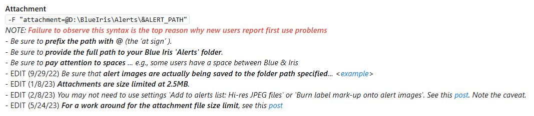

I also tried the message test shown above and this is the result
I'd suggest removing these unused entries as well:
--form-string "device=YOUR_PUSHOVER_DEVICE_NAME(S)_HERE"
--form-string "sound=YOUR_PUSHOVER_SOUND_HERE"
Sorry user is there - I deleted it when I deleted the pertinent info
-s --form-string "token=xxxxxxxxxxxxxxxxxxxxxxxx" --form-string "user=xxxxxxxxxxxxxxxxxxxxxxxxxxxx" --form-string "message=<b>&CAM</b> &MEMO <a href='&WAN/alerts/&ALERT_DB?fulljpeg'>Hi-Res</a> <a href='&WAN/ui3.htm?rec=&ALERT_DB'>UI3</a>" --form-string "html=1" --form-string "device=YOUR_PUSHOVER_DEVICE_NAME(S)_HERE" --form-string "sound=YOUR_PUSHOVER_SOUND_HERE" -F "attachment=@I:\Alerts\&ALERT_PATH"
Is 'Drive' the short name of the camera you are testing?
Blue Iris creates a temp JPG when you are not saving hi-res JPGs (Alert tab) or using 'Burn mark-up mark-up on alert images' (unchecked on the AI configuration tab).
These temp files are short-lived; therefore the URL links using them are ephermeral. They will not work, or will show the wrong image immediately after a new alert is created.
More here, here, and here.
EDIT: The 3rd link above has this 'paraphrased' suggestion ... In the Run a program/Write to file Alert action, try checking 'Wait for process to complete (up to 30 seconds)'. This prevents the action set from completing while the curl command is still transmitting the temporary image to the push service.
Drive is the cam name. I'll read the other links
I am saving jpgs in a Jpgs folder. Should I use that instead of the Alerts folder?
if you mean this setting, these JPGs are stored in the Alerts folder.
You should use the path is assigned the Alerts folder in the Settings > Storage folder...
OK, thats I;/Alerts
I was also saving jpgs in another folder on the Record page. I guess I don't need to do that..
So have you tried this yet?
In the Run a program/Write to file Alert action, try checking 'Wait for process to complete (up to 30 seconds)'. This prevents the action set from completing while the curl command is still transmitting the temporary image to the push service.​
I did check that.
I appreciate your help on this. I'm being yelled at because the family is going to dinner. I'll have to leave but maybe I can connect with you tomorrow.
I was having issues with alerts being sent after changing the path to where the alerts are being saved. While typing this up I now see that I should have looked at this first... however...
If alerts should be workings, but aren't through PushOver, I was able to test via cmd.exe and then deleting arguments until I got a response back there. Essentially, my path to the image was incorrect as a SPACE was in the original path, but not the new path... Deleting the path from the cmd.exe test showed it very quickly. Hope this helps someone else.

Excerpt from the API Syntax Reference Guide in post #1.
