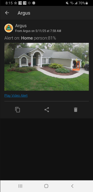

This is odd. It's not specific to Pushover but it was a lack of a playable link generated by curl for the Pushover notification that brought this to my attention. See the Pushover notification below. The "Play Video Alert" link when clicked would no longer automatically open up UI3 then play the alert clip and this started happening a few days ago but it had been working for a couple of years.
LINK CREATED BU CURL:
-s --form-string "token=token redacted" --form-string "user=user redacted" --form-string "message=Alert on: <b>&CAM</b> &MEMO" --form-string "html=1" --form-string "device=MobilePhone" --form-string "sound=siren" --form-string "url_title=Play Video Alert" --form-string "url=&LAN/ui3.htm?rec=&ALERT_DB&maximize=1" -F "attachment=@E:\BlueIris\Alerts\&ALERT_PATH"

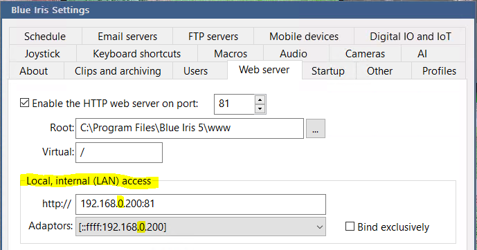

When I took a closer look at the above link I realized the IP address above is wrong. Instead of 192.168.1.200 the curl is generating 192.168.0.200. The curl command uses the variable "LAN" to insert the IP address. Somehow the Local, internal (LAN) access setting in BI changed. Anyone have any idea how the LAN changed by itself in BI settings?
BTW, the third octet being 1 is for my home network while 0 is for the camera network as I have a BI system with two ethernet controllers.

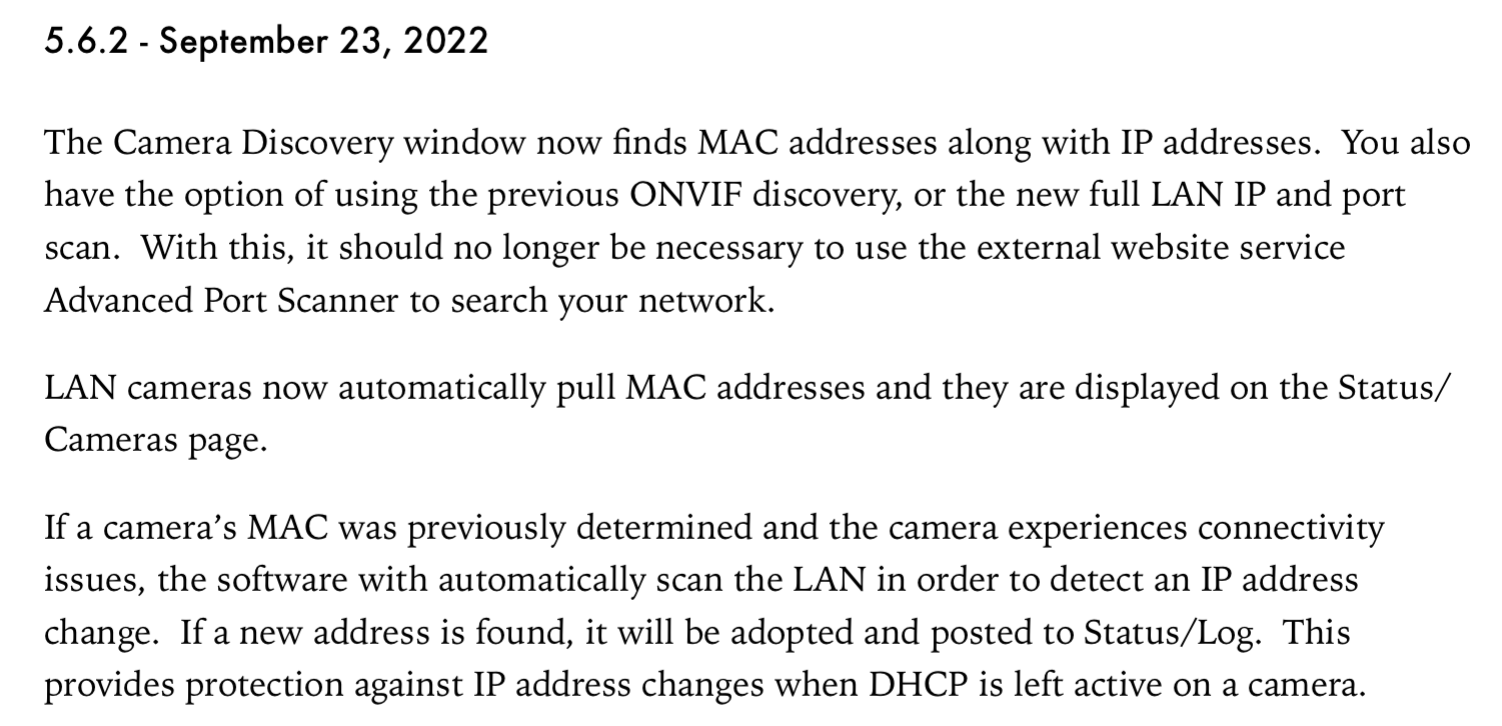

Did you perhaps have a situation where the Blue Iris 'Camera Discovery' process was recently used?
Relevant excerpt from the Help PDF...
Reactions: Sybertiger

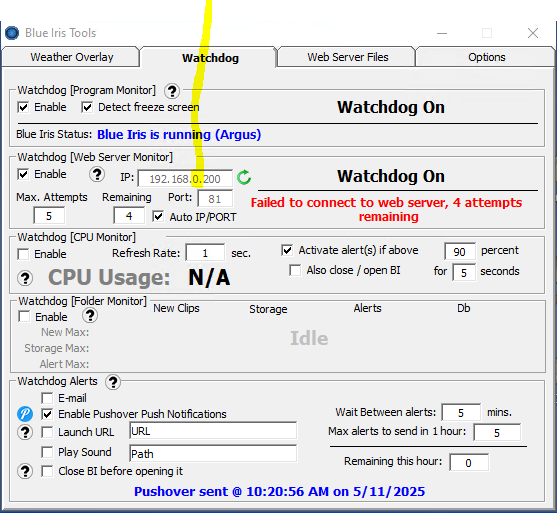

This started as a Pushover issue but we can see this is really a BI issue or some systems setting issue on the computer. I'll move this question over to the BI threads. I have an older version of BI. The other thing I see is BI Tools has the wrong IP address and now I'm getting a failure to connect to the webserver as a result of this. But since I changed that third octet from 0 back to 1 like it's supposed to be my Pushover link is generated by curl just fine.
