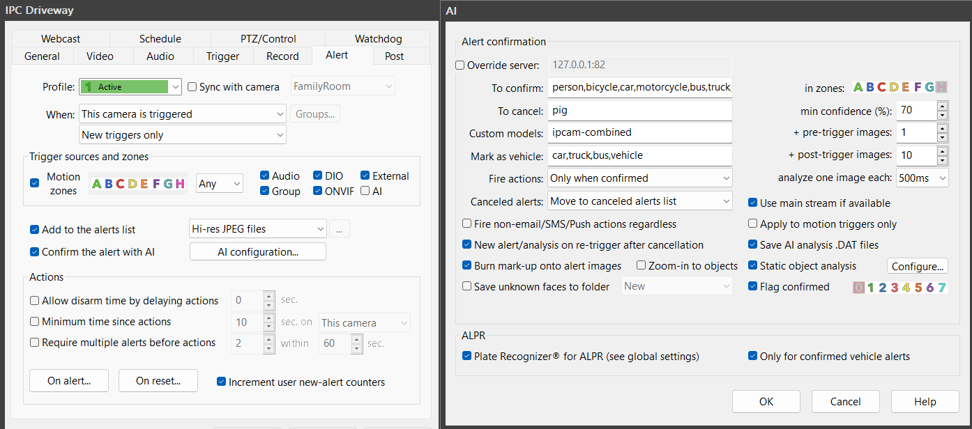

Thanks - I am creating high res JPGs and I am creating the AI markup images, so seems that doesn't apply to me then?
Ugh. I've just parsed your command syntax. Everything appears to be in order.
Correct.
I looked at the first post that you linked (here) where the user was having a similar issue, but I don't think that applies, since I have the defaults checked on the record tab of this particular camera (and all my other cameras sync with this one). Please let me know if that's not correct though.

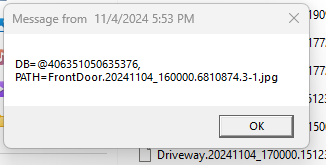

Try my 'msg.exe' trick... Insert the following 'Run a program' action before the pushover curl action.
This should pop up a window that shows the expanded macros, so that you can confirm that the JPG path in the curl command is as you expect.
Here's the 'Parameters' field text * /TIME:5 DB=&ALERT_DB, PATH=&ALERT_PATH
Increase the TIME value if you want the window to stay open longer.

Thanks - just tested and it seems to be coming back correctly
When I look in the alerts folder, the jpg file in this PATH is the correct JPG.

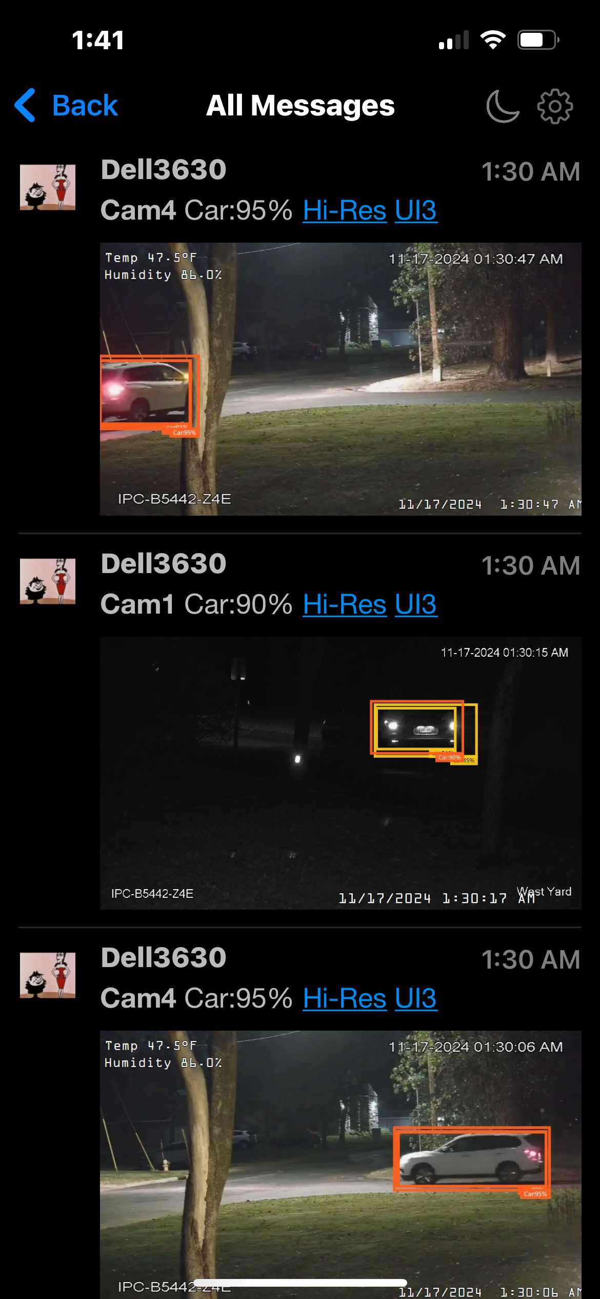

Anyway, I hit the lightning bolt test icon, and it sent a notification to my phone.
Yippee.
Im running CP AI on a couple cams. so it asked for an AI alert type, so I put Car, Person
I'm just trying it out on the LPR cam 1st.
